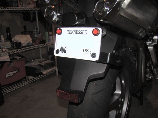

The rear bracket was supposed to mount on the license plate bracket but on my bike the license plate was too high. There is a hole in the rear fender beneath the license plate bracket that is exactly the right height though. I drilled a hole in the bar and used that hole for the main bolt, and added a couple of smaller bolts through the bottom holes of my license plate to keep the bar from pivoting when the racks aren't installed.

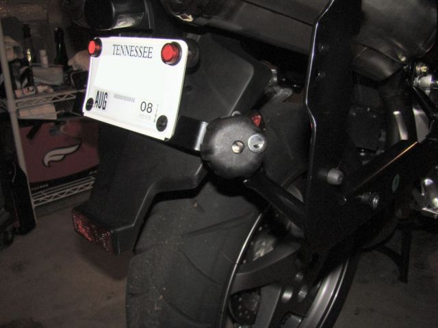

They have some optional locks that take the place of one of the quick-detach fasteners. I got them, but I'm not sure I would again. They are a good idea, but the only place they will work on the VFR is on the rear bar locations. I think it would be pretty easy to turn the fastener with a pair of pliers and bypass the lock, so I think they were pretty much a waste.

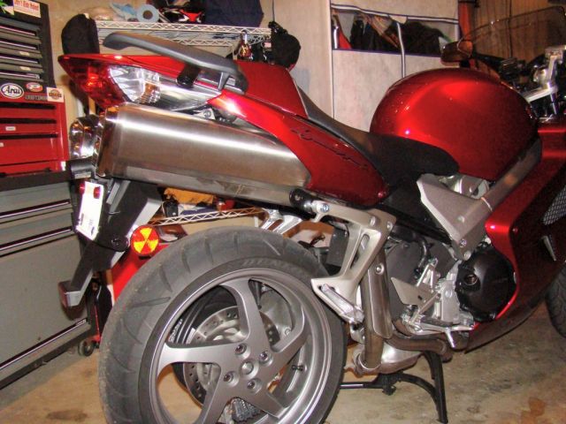

The photo below shows the three tabs that the side racks mount to:
They are somewhat unobtrusive so if you don't see them here is a photo that points them out:

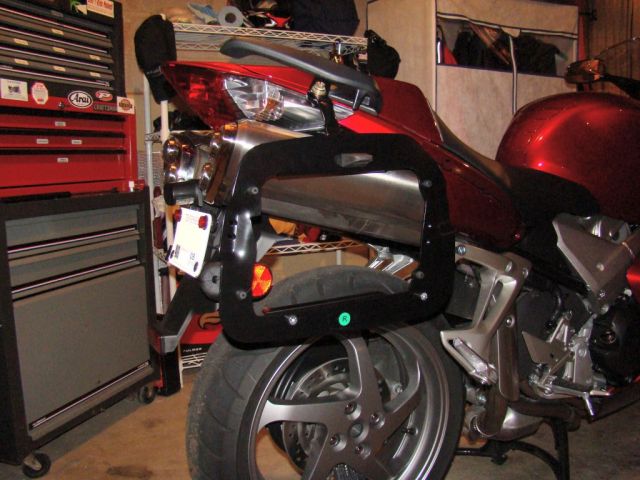

Here is the bike with the side rack mounted. Takes about 15 seconds to mount it to the three tabs:
Here is a closeup of how I mounted the bar across the rear. There is a bolt in the center that is covered by the license plate that handles most of the load. The two smaller bolts through the lower license plate holes really serve to prevent the bar from pivoting when the racks aren't installed. That bar could probably not even be connected to the rear fender but it does make everything more solid feeling when it is.
Here's a closeup of the lock on the back of the rack. I'm really not sure how much good it does, but I guess it will slow down a thief for a couple of minutes. Personally when I stay at a motel overnight I plan on taking the racks inside. It only takes a few seconds to remove them and I'll sleep a lot better knowing that I'll still have them in the morning.
The only other real down side is that the grab rails have to be mounted or everything will be too short. The top tabs mount on top of the grab rails and replace the original grab rail bolts. The grab rail covers could be drilled out and some longer spacers fabricated that would work, but I chose to just put my grab rails back on.

Well those photos make it way too clear to me that the Givi solution is much easier to make it look like it is not there than the Factory Honda frame rails. Thanks for the pictures. Maybe I need another VFR to mount the Givi rack/cases to?
