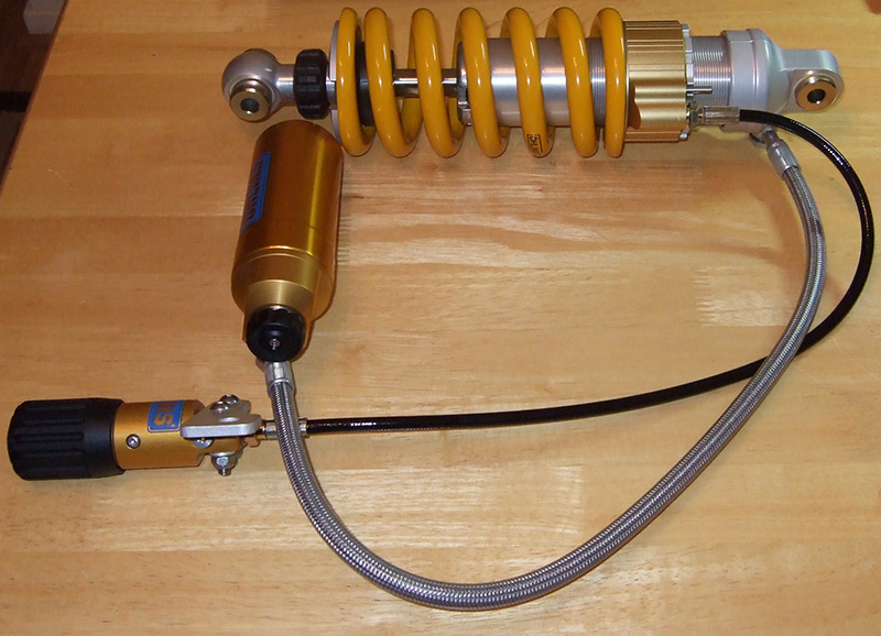

What up? No install help from Kyle? You just don't get much for a thousand bucks anymore!
I dunno...I'll let you decide. Presenting: Ohlins model HO801, for a 1999 Honda VFR 800 FI.
I've done this swap a bunch of times before, so I know the drill. Virtually every bike I've ever owned, other than my first VF500F, I've swapped the shock out for an aftermarket one. This will be the first time I don't have to hang the rear of the bike in the air with a tie strap around the subframe to get the shock out, which is cool.
