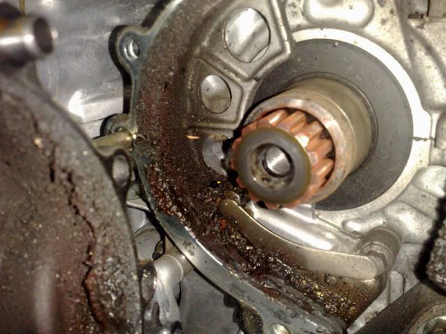

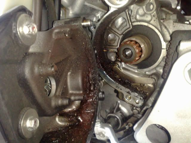

    remove the old chain and sprocket and that sadly displays
    this is where your 1 hour chain swap turns into a 2 hour chain swap. no proud viffer would just overlook this buildup of crap and continue on with the install. so, a can of wd-40 and 2 filthy shop rags later, she looks something like
    not perfect, but not bad
    here's the pile of crap i dug out of there

    My sprockets looked just like yours did. The front was rusted in the same manner. I have no explanation for the rust. Cheap material used by the sprocket maker?
    I had an equivalent amount of gunk in the countershaft cover. I was contemplating doing photos but I would have ruined my camera.
