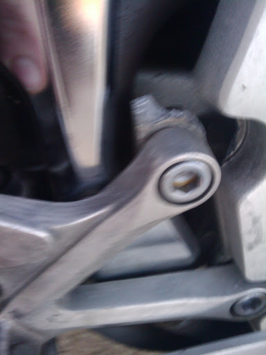

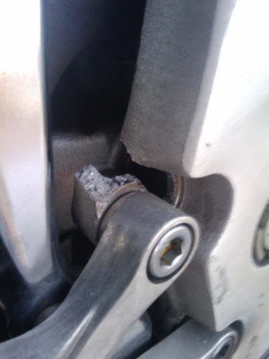

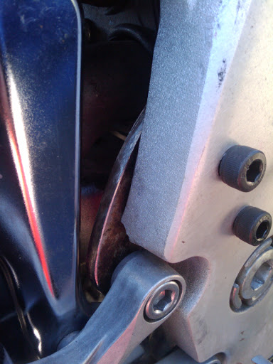

Had a low-/no-speed 'happening' last night...
A stretch-pantsed *#$@'#!! at Wal-Mart managed to back her SUV over my 97 VFR and push it off the center stand on to it's side (and you can really tell it's 900+ pounds dead lifting them!)
Didn't really do any damage except as pictured below - the peg bracket hit the parking space barrier-thing and...
Any chance that can be fixed short of replacing the frame??

Maybe even some JBInstaweld may hold it. Looks like frame damage to it. That would be a total.

I would think it easily repaired ,but insurance company will most likely total it over this.If I can lend a hand with repairs let me know.

A good welder can fix it easily....if you can find one.
It's best to find a safer parking spot away from the morons and idiots and half-blind senior citizens.

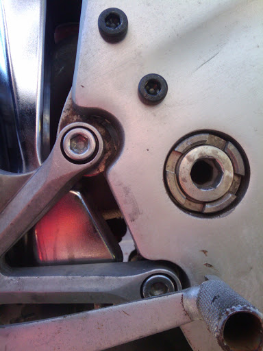

Unfortunately, it was a hit and run, I got some video from the WalMart parking lot camera but no plate ID... She just barely nudged it over off the center stand and didn't seem to have actually run it over... (small favors)
Funds (lack thereof) dictate that the first attempt was the 5-inch C-clamp and J.B. Weld for 4 hours this afternoon... Bracket lined right back up with just a hair of reaming the upper bracket mount... I put it up on the center stand and hopped my 170# ass up and down on just that peg and it seems to have held... I'll keep a close eye on it over the next few days and I Red Loctite's the bolt in the good part of the frame just for good measure... I traced down a 97 frame in a junkyard here in Dallas for 350$ if it doesn't work...

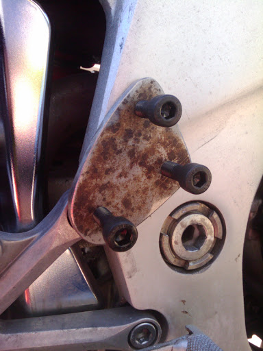

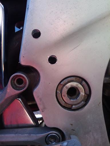

Well, JB Weld didn't do the trick, so I went a step farther than I probably should have...
The plate is steel (I know, I know - corrosion) but (not shown) there's a "gasket" between the frame and the plate made out of 1/4 sheet nylon and the bolts are Stainless Steel and black anodized and slathered in anti-seize... (also not shown are nylon under steel stacked washers on the frame side)
I'm not sure that drilling that close to the swing arm bolt is recommended, but I plan on keeping a close eye for cracks there and I'm going to replace the frame once the last few riding days of the season are done as a winter project anyway...
