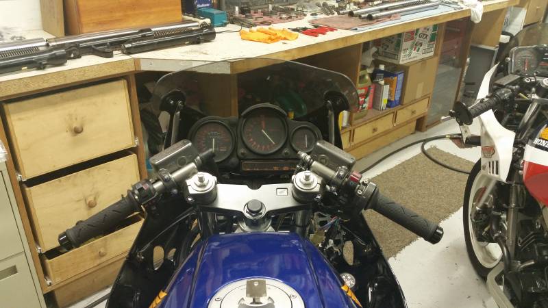

    Fabricated all the stays and mounts. Here's an early version where I was running some mirrors close the the stock location
    Then later finished the upper cowl mounts with the instrument stay I was planning to use.

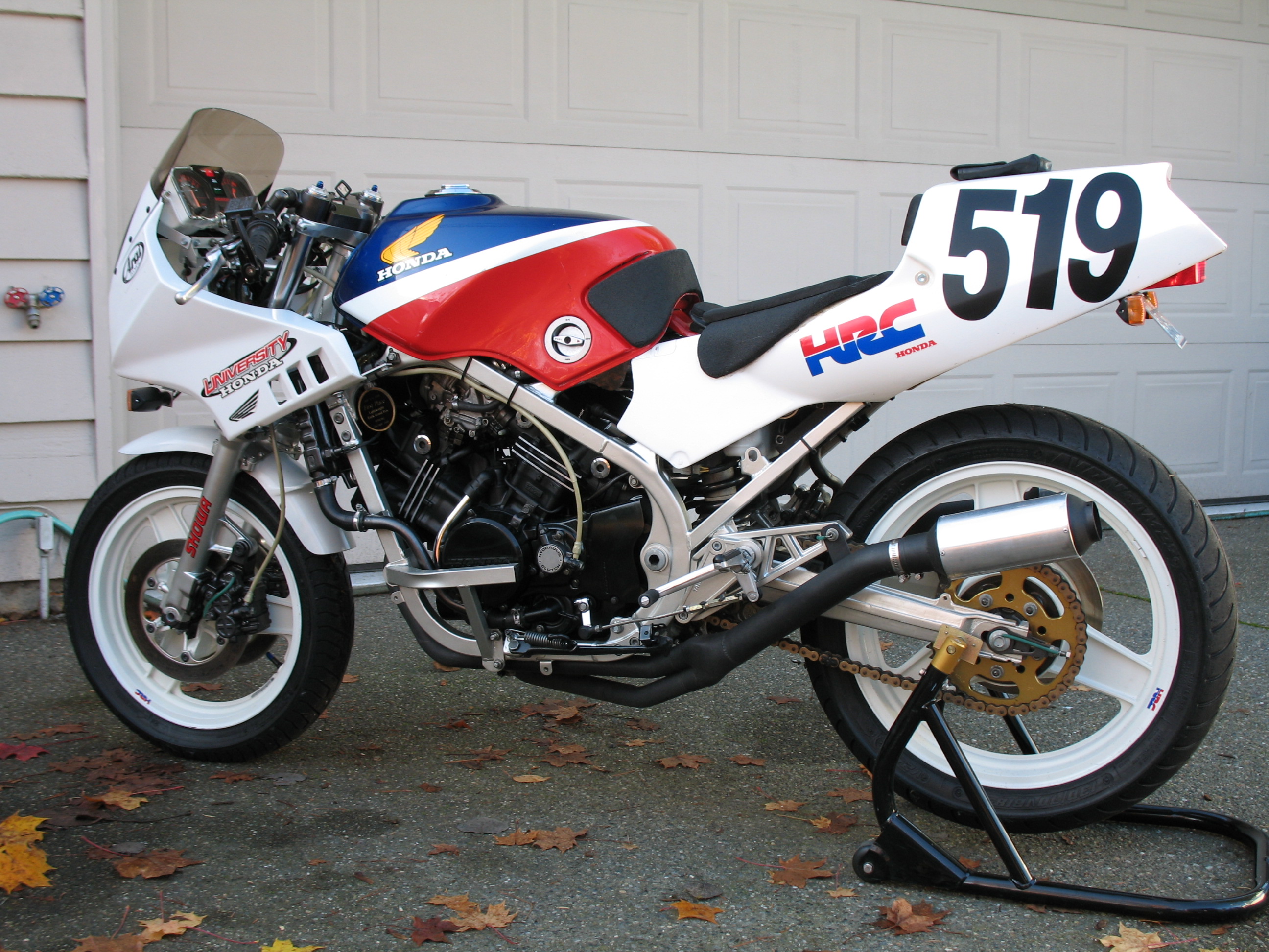

    I toyed with the idea of running a RS tail similar to this
    But when I scored the Cobalt Racing tail at a stupid price I decided I'd had enough fab on this bike and the idea of a real seat sounded good.
