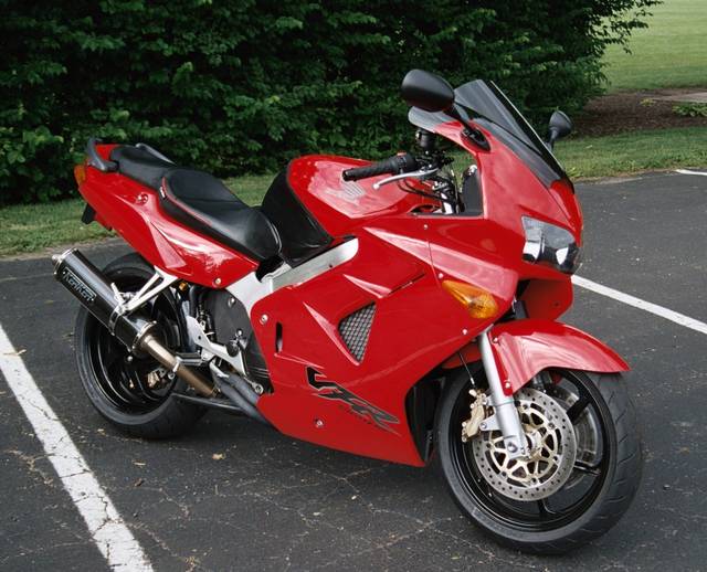

    7,489
    3,563
    THAT'S the front end that should have came on the 98 in the first place. In 2002, it became a Stupid Fucking Spaceship... might as well make it even more complex at that point.
    "SFS" comes from my "opportunity" to work on a '02 VTEC/LBS/ABS model. A Borg Cube is less densely packed and complex.
    I would have considered an '07 Anniversary Model.... until about day 5 that thing was in my shop. I got it running, gave it a once thru and fixed some other things, experimented with some different maps, test rode it... and told my friend it is never coming back into my shop ever again.
    mello dude likes this.
  13. MiguelDK
    MiguelDK New Member
    Denmark
    Oct 3, 2023
    56
    21
    Wow! That looks really clean. Is the front forks and calipers from the CBR? What does the rear brake look like in this setup?
    7,489
    3,563
    Basically, the rear would look stock too. Source a CBR rear master cylinder (for the correct diameter for proper pedal feel) and run 2 lines to the rear caliper on a double banjo bolt, or run one line and do just a small jumper line to the second fitting on the caliper. Looks stock and you lose about 3 miles* of brake lines and 700 pounds* of proportioning / delay valves and related hardware. (*approximate values)

  15. Terry Smith
    Kuwait
    2,864
    713
    Forks are CBR600F4i. Callipers can be from the same but the best combo is the CBR954 calliper and 600RR master; better hydraulic ratio IMHO. I ended up with a CBR600F4i fender as well, 6G VFR triples and bars, all of which just bolts together like Honda intended. The only mod was to space the ignition down by a few mm (using washers) to allow the steering lock pin to engage the socket on the frame.
    At the back I used another CBR600F4 master cylinder, and joined both stock hoses to that using a double banjo. The rear calliper is 100% VFR including both hose connections. The brake hose that normally goes to the front link reaches the rear master very naturally.
