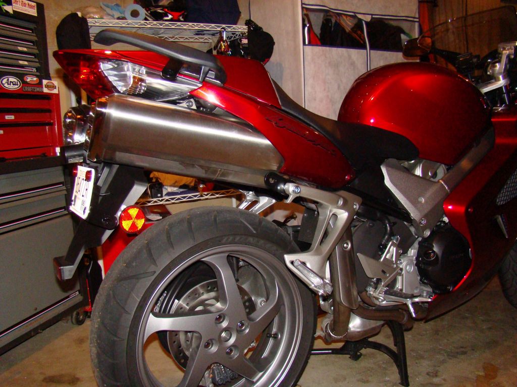

    The photo below shows the three tabs that the side racks mount to:

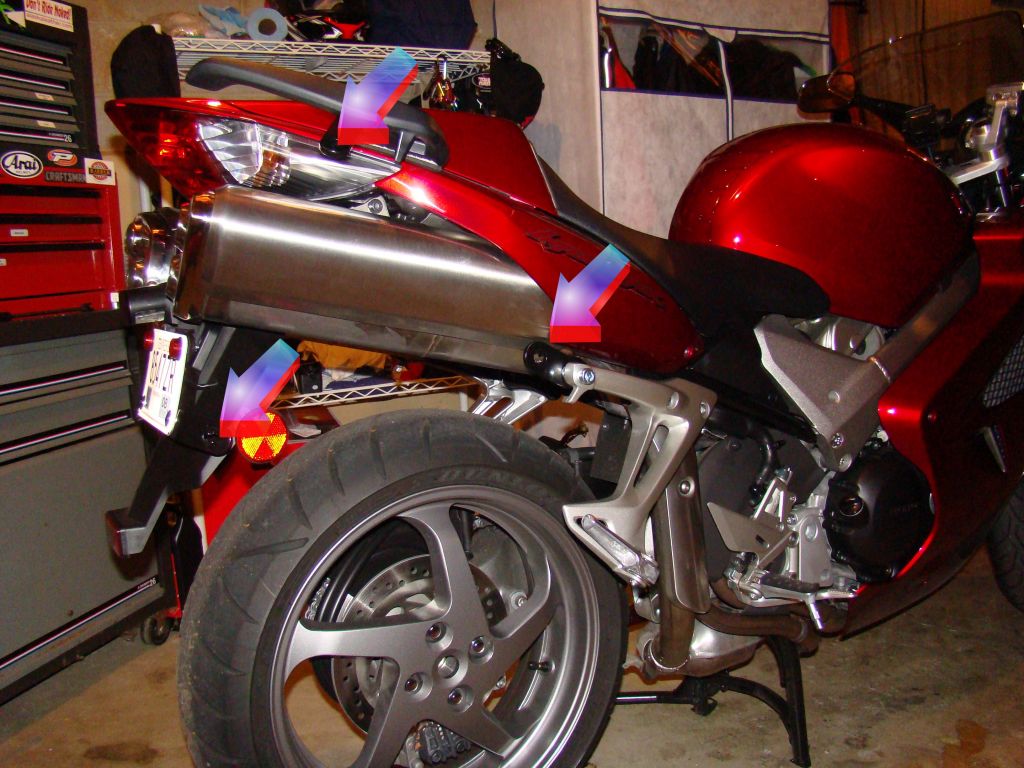

    They are somewhat unobtrusive so if you don't see them here is a photo that points them out:

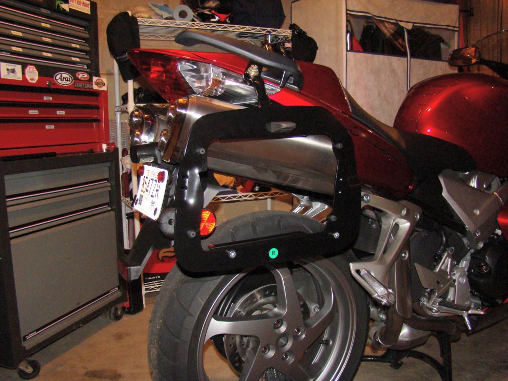

    Here is the bike with the side rack mounted. Takes about 15 seconds to mount it to the three tabs:

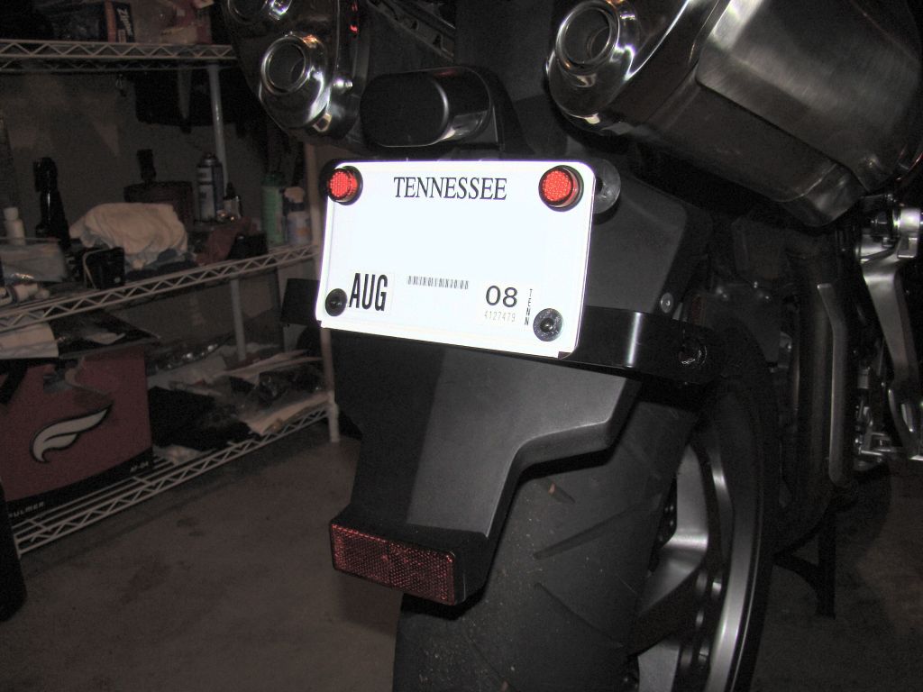

    Here is a closeup of how I mounted the bar across the rear. There is a bolt in the center that is covered by the license plate that handles most of the load. The two smaller bolts through the lower license plate holes really serve to prevent the bar from pivoting when the racks aren't installed. That bar could probably not even be connected to the rear fender but it does make everything more solid feeling when it is.

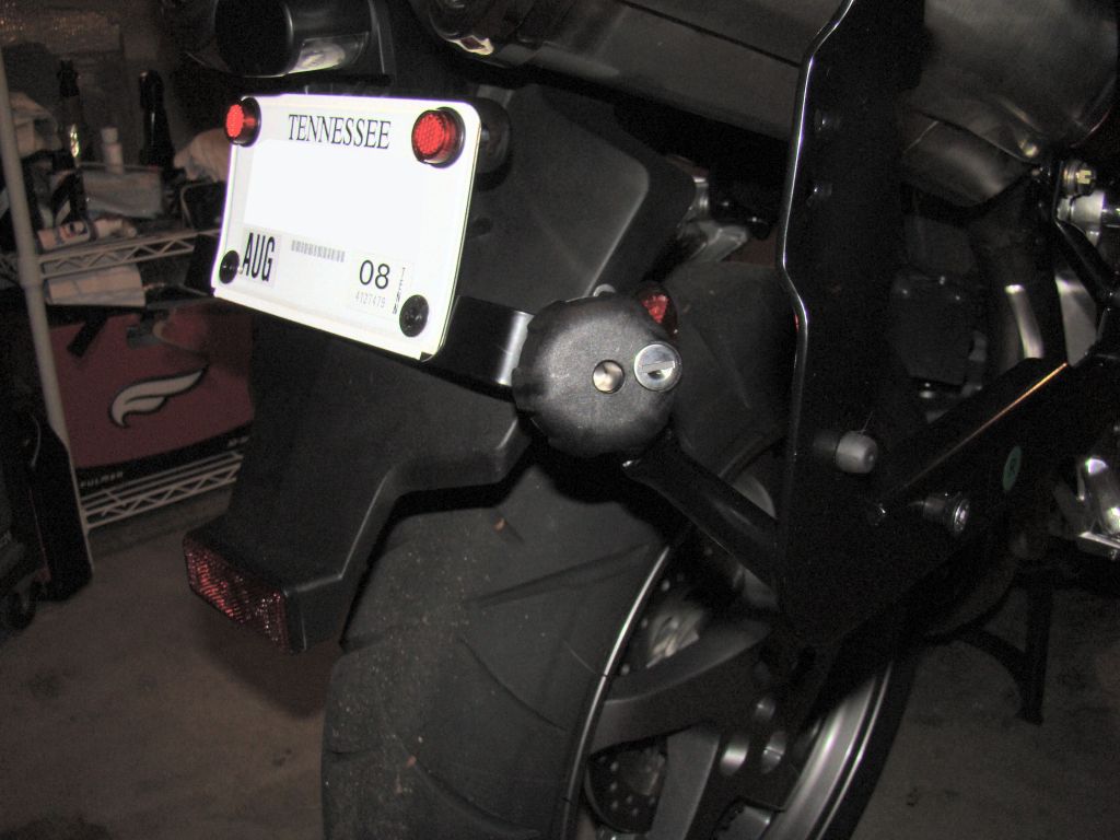

    Here's a closeup of the lock on the back of the rack. I'm really not sure how much good it does, but I guess it will slow down a thief for a couple of minutes. Personally when I stay at a motel overnight I plan on taking the racks inside. It only takes a few seconds to remove them and I'll sleep a lot better knowing that I'll still have them in the morning.
