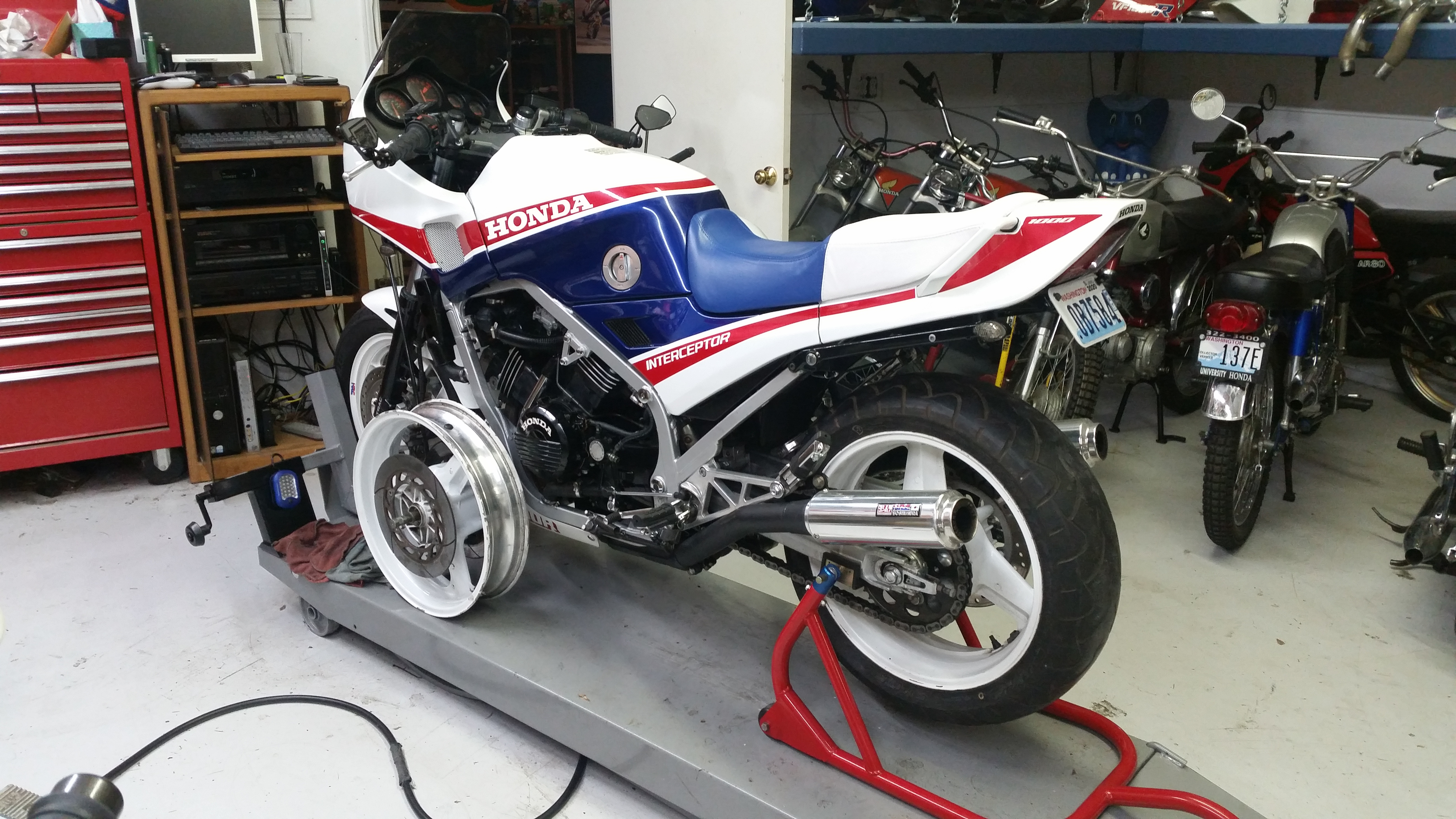

    Finally got around to machining the hub to my specs today at work.
    This bike is getting front and rear 1990 CBR1000F wheels, 5.5" & 3.5" x17
    I'll post the first mockup pics this week I hope. Last item to machine is the right rear spacer after I figure out what it needs.

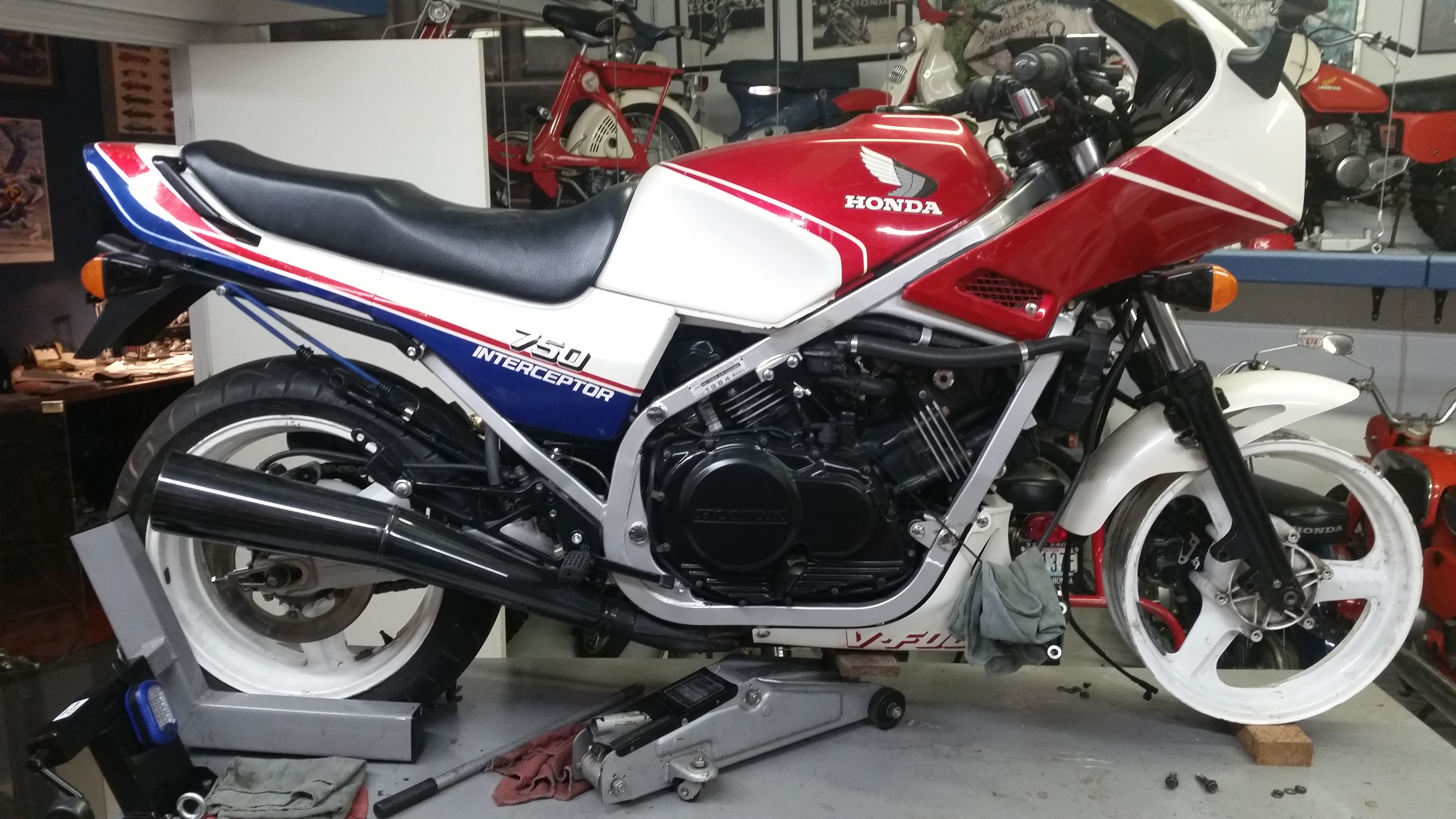

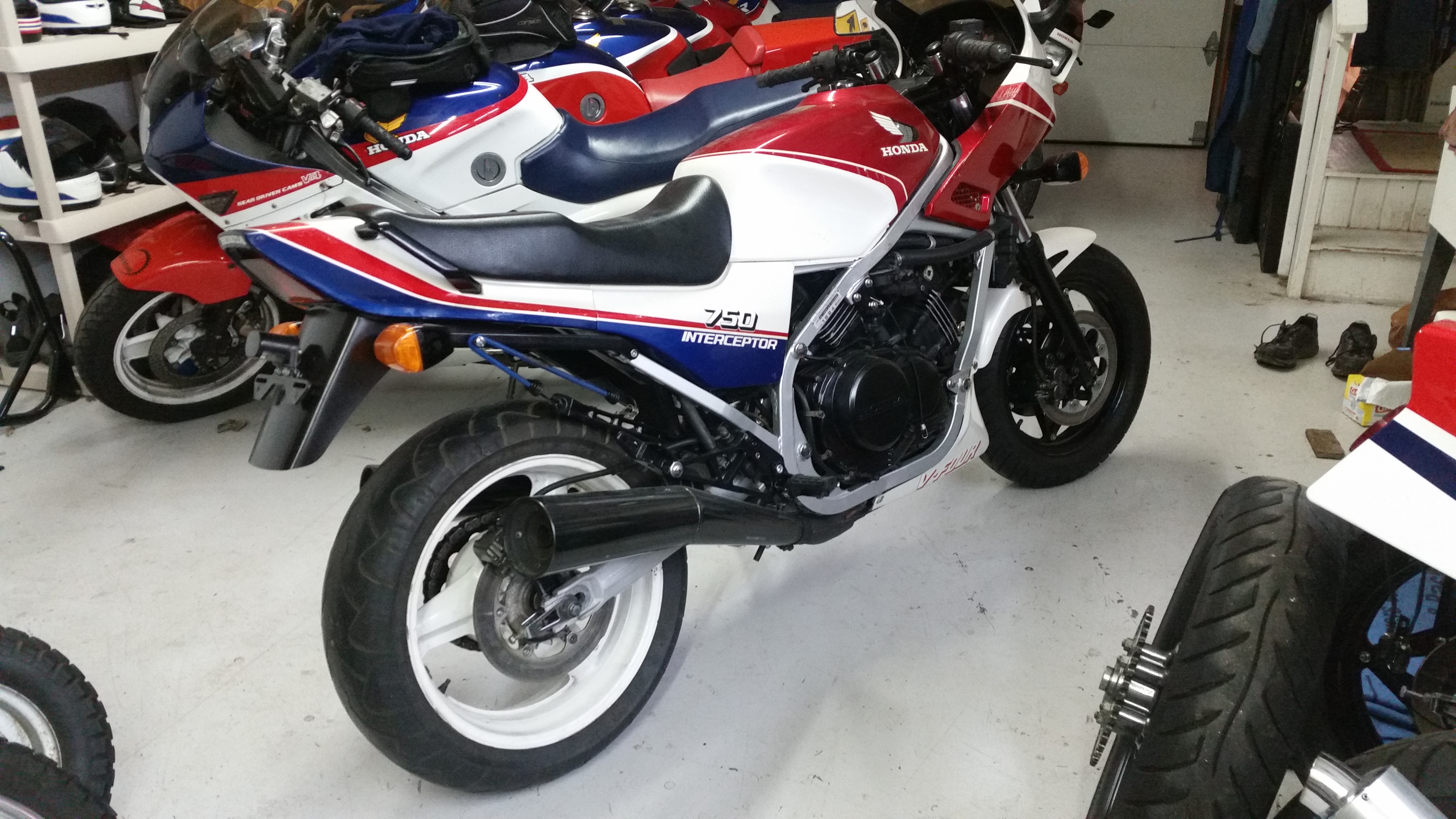

    Decided to use an 84 VF750F for figuring out the spacers so I wasn't hacking around on the 1000F. The rear turned out pretty easy. I already machined the correct left spacer to mate with the hub and I was able to use a combination of OEM spacers on the right and it's perfect. My measurements and machining were spot on.
    The front was a little trickier due to change in bearing and axle sizes for the wheel. Finally got it centered and I know what spacers I need to modify. Just have to shorten 2 stock spacers. Right side dust seal is gonna fit by .5mm.

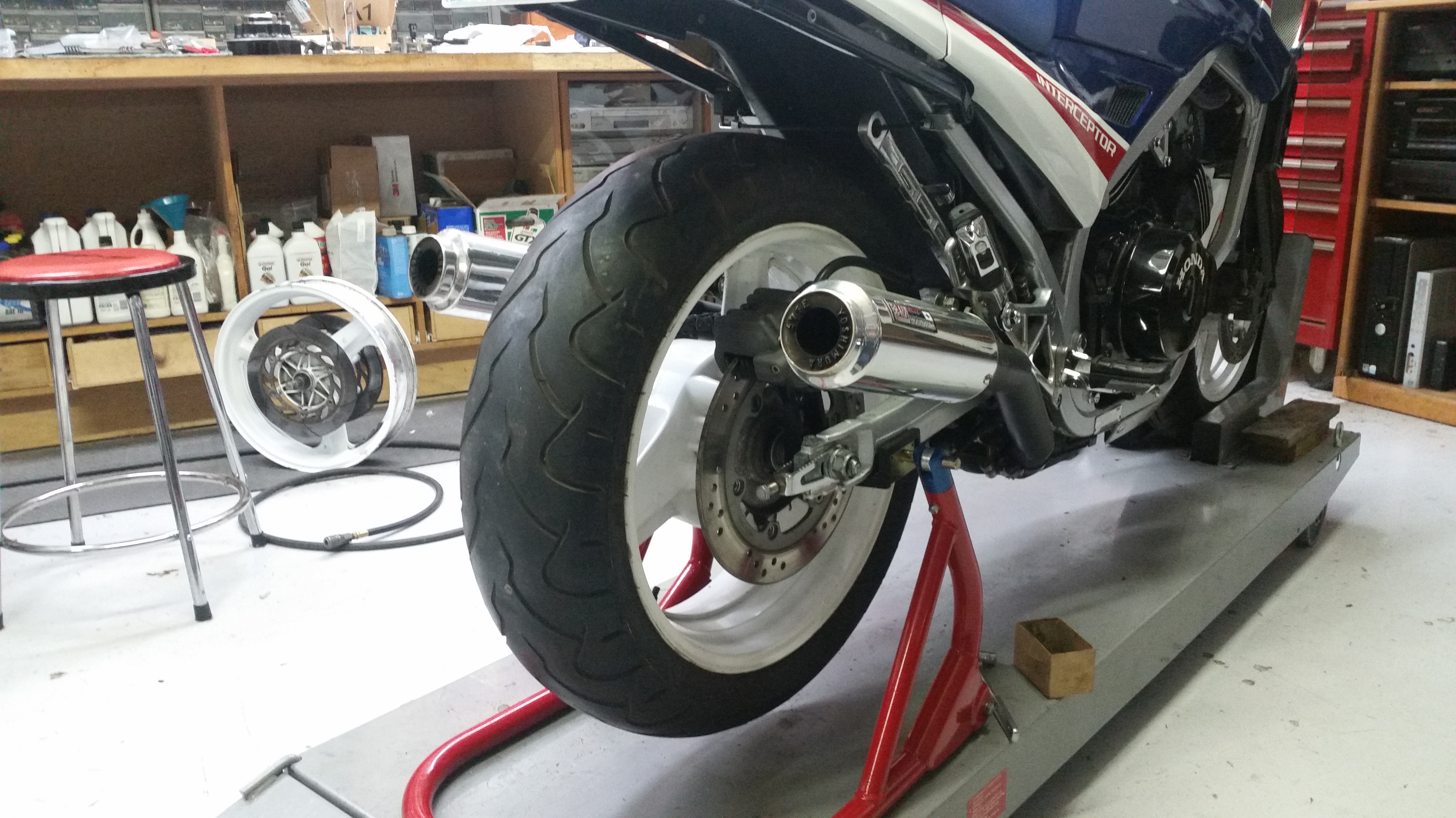

    Decided to fit up the rear on the 1000F now the monkeying around was done.

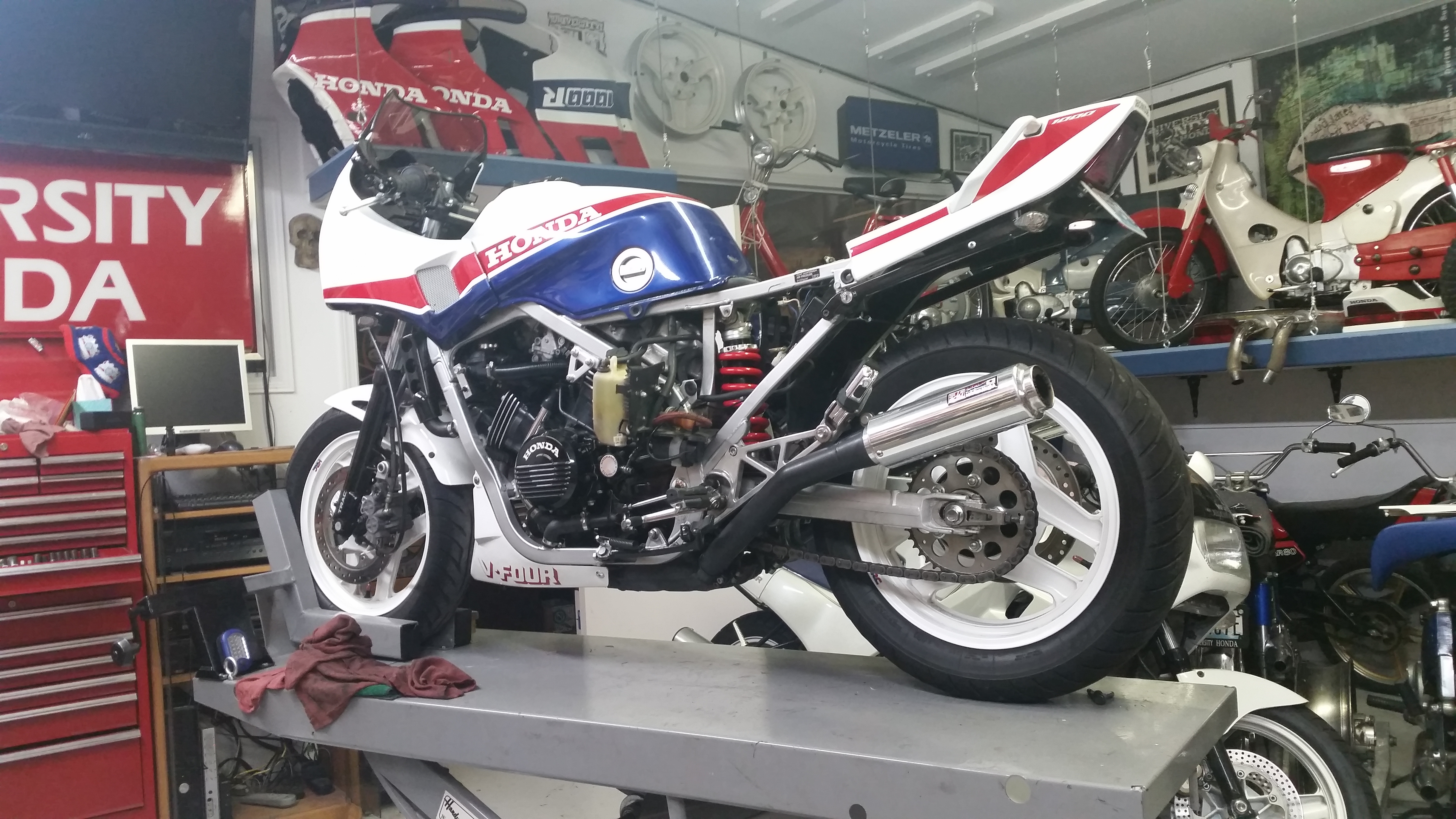

    YSS shock #2. Gonna need more ride height with these wheels than the Daugherty F2 shock is providing. This is +5mm over stock with another +5 available. I love the YSS I put on the 86 1000R wheel swap bike (exact same shock). The F2 shock should be usable on my stock 1986 VF1000R.
    $375 shipped from the U.K. Pretty good deal I thought. Now I need to build a 2nd set of 1000F forks I have so I can just swap out the front end when I'm ready.

    Trying to make some progress. Swapping in the new shock that can provide the needed ride height. I have a couple fuel filters arriving tomorrow... look at that tasty 'orange' unit hanging there. When the fuel filter is in the center of the bike it probably doesn't get the love it should.
    Here's the shock progression: Stock (400mm) / CBR600F2 DMr conversion with Hyperco spring (about 407mm) / YSS 405 set at about 412mm (it's technically a +/-5mm shock but I added a couple mm, there's plenty of clevis rod engaged in the shock and it's right at the limit mark, could probably add a few mm if needed no prob).
    The DMr shock will go in my 8K mile 1986 VF1000R (perfect.. couple mm longer than stock) and I'll wrap up the stock shock. I'll keep the dampening adjustment cable and air hose mocked up for a stock appearance.

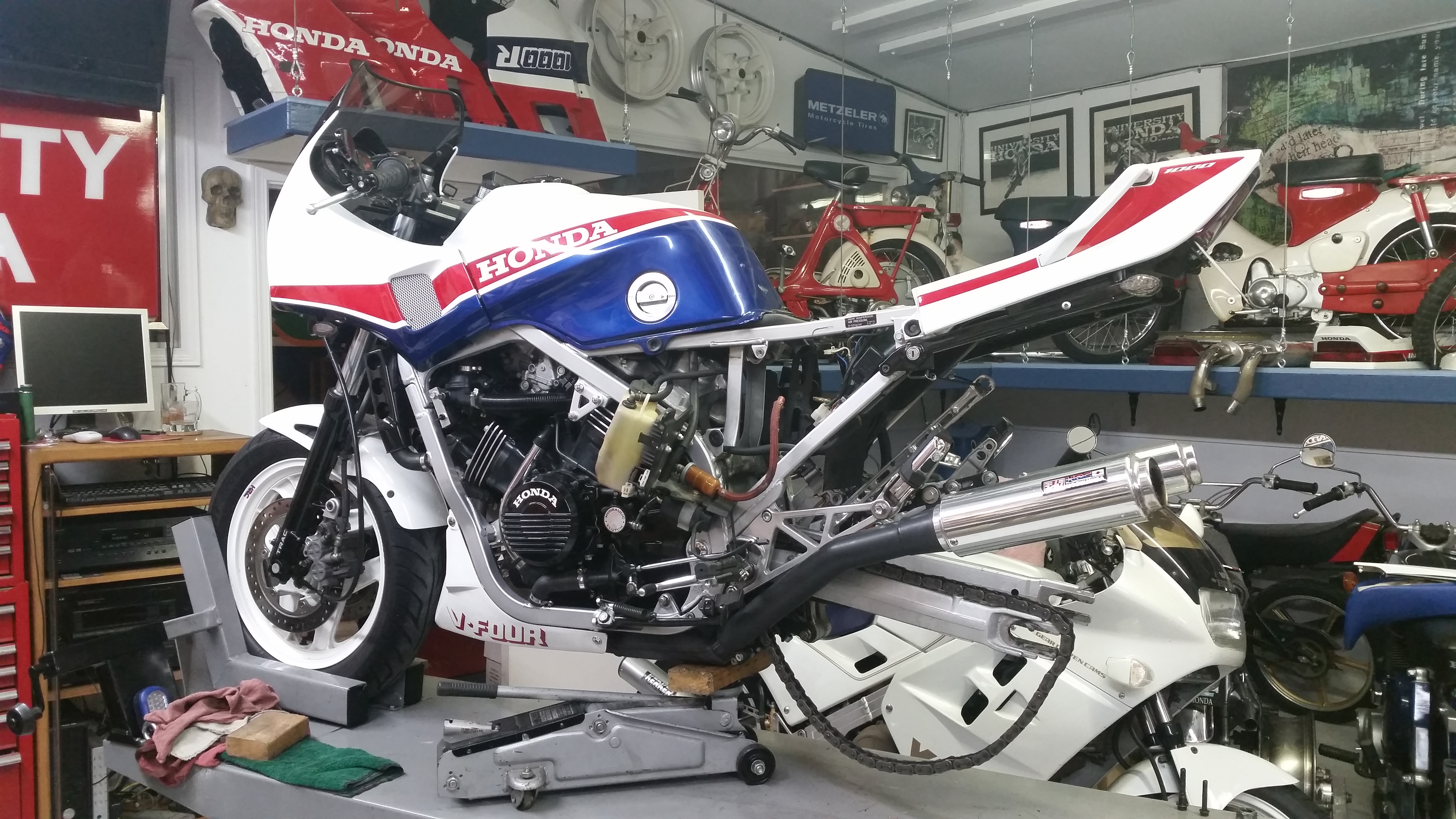

    Shock installed with the stock wheels while I finish ($) the forks, rims, spacers and buy tires.
