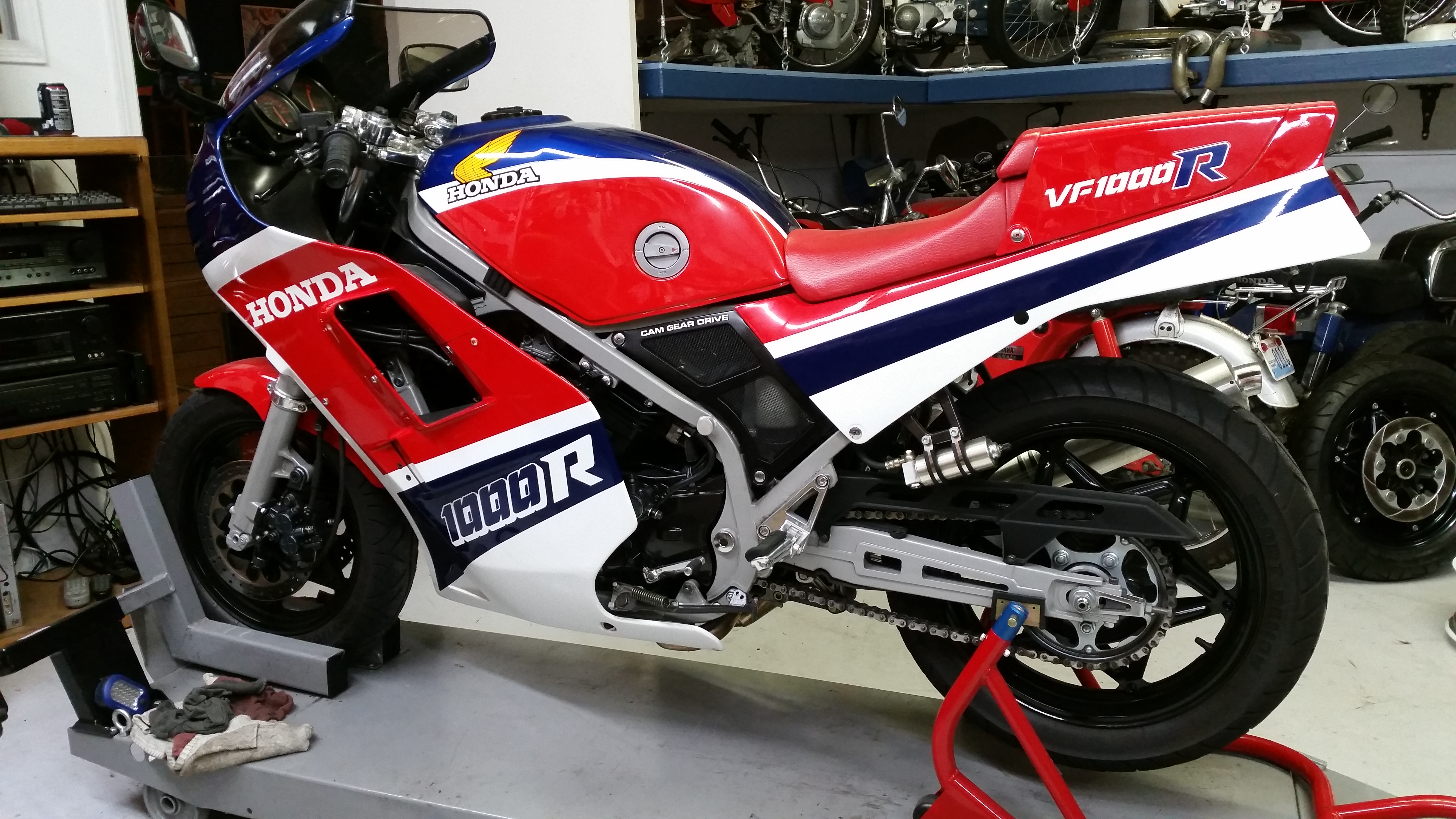

    8,510
    4,482
    Back together. New 1.0 springs, Race Tech Emulator on compression fork, front braided lines. And of course new tires on restored wheels.
    It's stiff! I'll put some miles on, but I may be adjusting the preload and/or oil level. But it does feel awesome just rolling around the shop.
    And I almost forgot to balance the front wheel before installing. Just get so excited.

    8,510
    4,482
    The bodywork really isn't the issue. It's the inner radiator ducting shroud. I have to use a shorty allen wrench with a little tube extension to loosen and "torque" the lower triple clamp bolts.
    I did run into something unexpected while updating the forks. One of the compression side bushings was very worn and the oil was super dark with coating that came off. The other bushing in that fork still looked perfect. The chrome tube is perfect and fork wasn't leaking. I luckily had another nice bushing from some parts out of another set of forks. Flushed the fork out a few times until clean fluid came out. The oil in the other fork still looked bright red and new. Weird.

    I had to go to the Post Office, so I did a shake down run.
    Fucking awesome. Preload and oil level feel just about perfect. Compression damping feels a touch harsh around crappy city streets, so it's probably pretty damn close for the valley.
