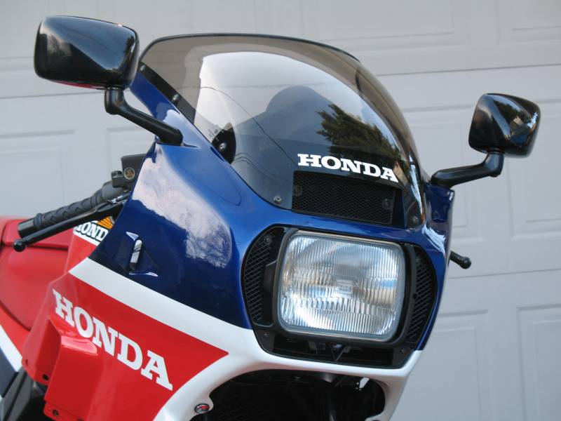

    Why do you need a headlight? Or do you need the surround that goes around it?
    If you have an 86 upper cowl and the single 85 headlight, there is nothing for the upper part of the 85 headlight surround to attach to.
  18. Edd
    Edd New Member
    Apr 27, 2021
    15
    I have a single headlight. Are all the 86 cowls dual headlight?
  19. Captain 80s
    7,645
    3,720
    Yes. Maybe not the best example, as this is an 86 I rebuilt using half 85 and half 86 cowls, but you get the idea.
    The 86 headlight fills the entire area, not allowing for the upper mounts for the 85 headlight surround. I eliminated that tab on the left (our right) 85 side.
