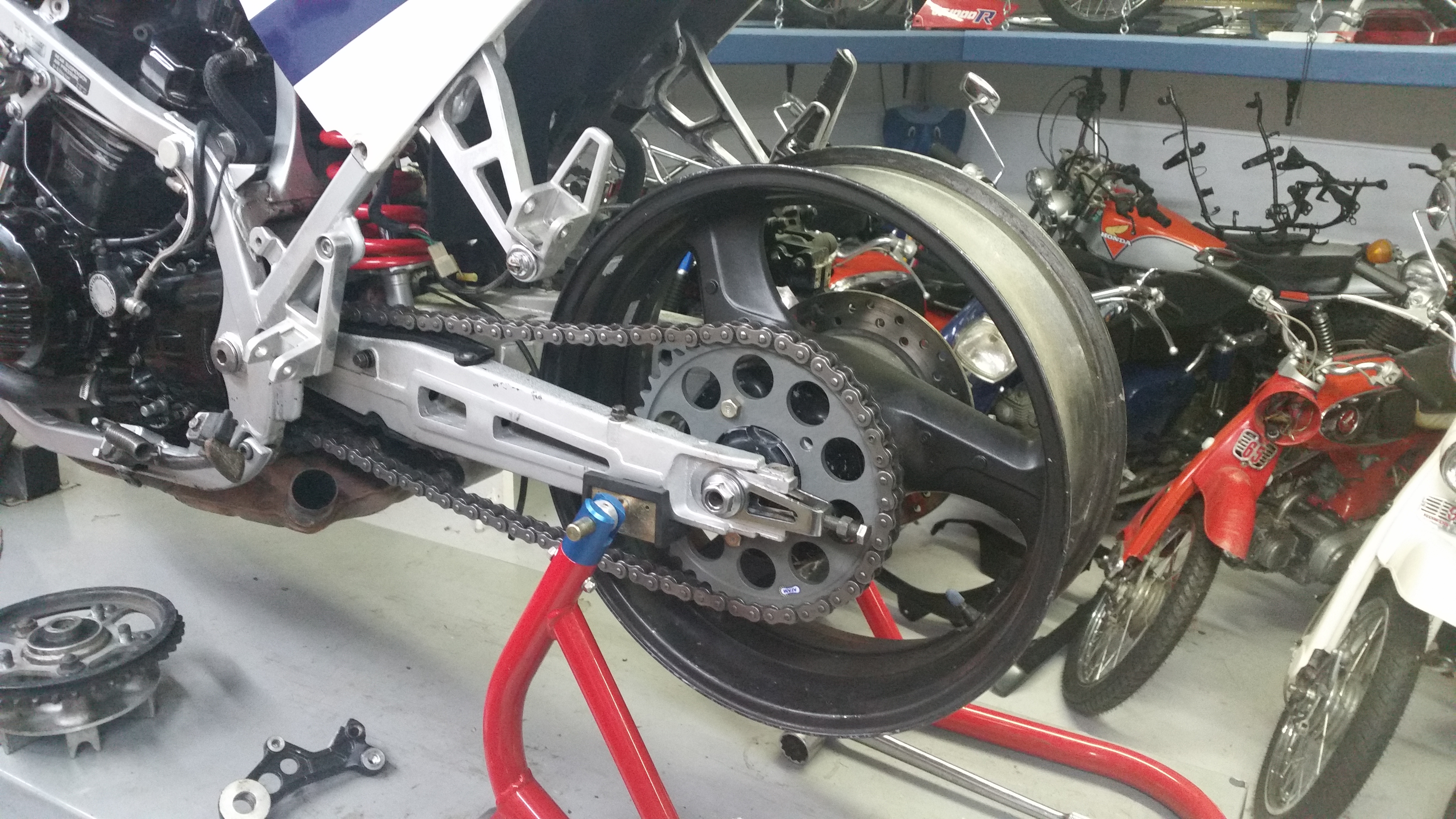

    Perfect fit and chain alignment is spot on. It was a huge relief to see that my calculations and measurements were good. The slightly sucked in hub was a good idea, looks really good without the little gap that would have been there.
    I have the final right hand spacer to make after checking actual fitment. Gotta work on the brake carrier now. I'm going to make a short torque arm that will go from the 929 carrier and attach to a bracket bolted to the swingarm. The 929 carrier is getting a machined sleeve pressed in to bring it down to 20mm. Eventually I would like to do a hanging caliper using the original torque arm, but I haven't found the perfect candidate yet. The 1000R caliper won't clear the wheel. It will on a F3 wheel.

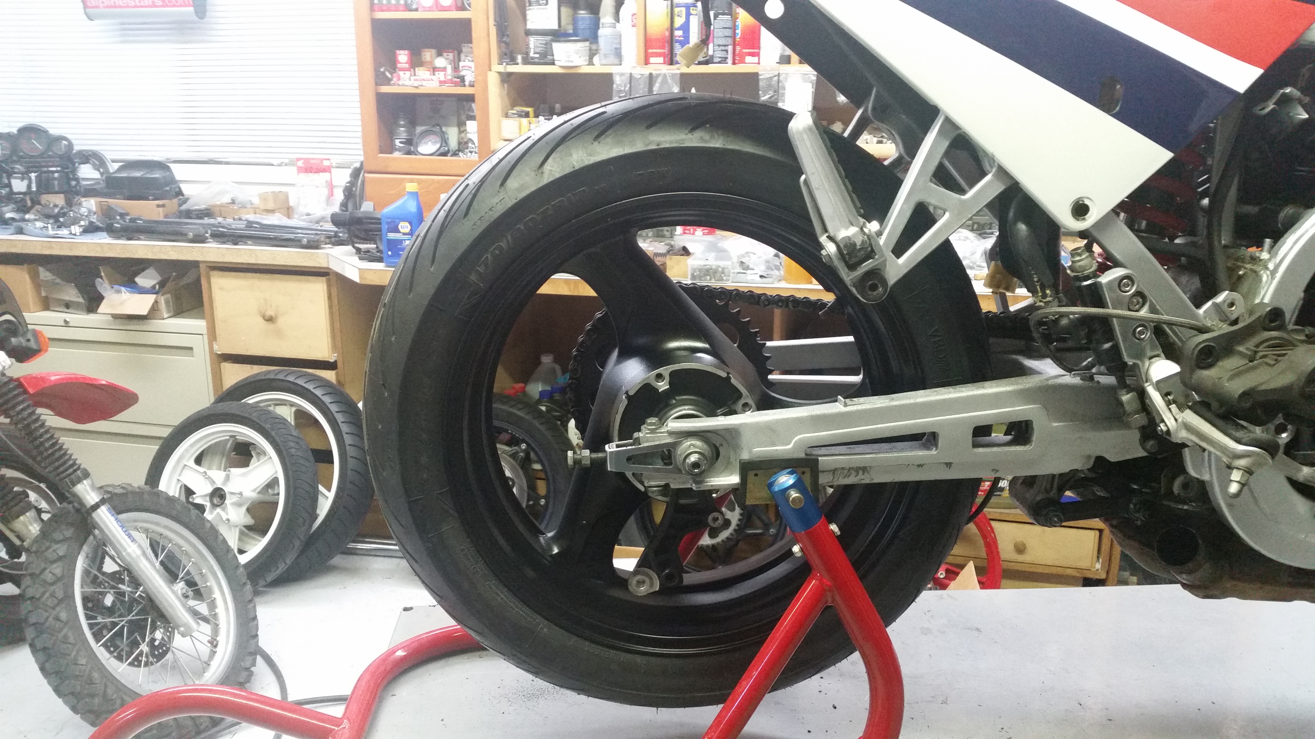

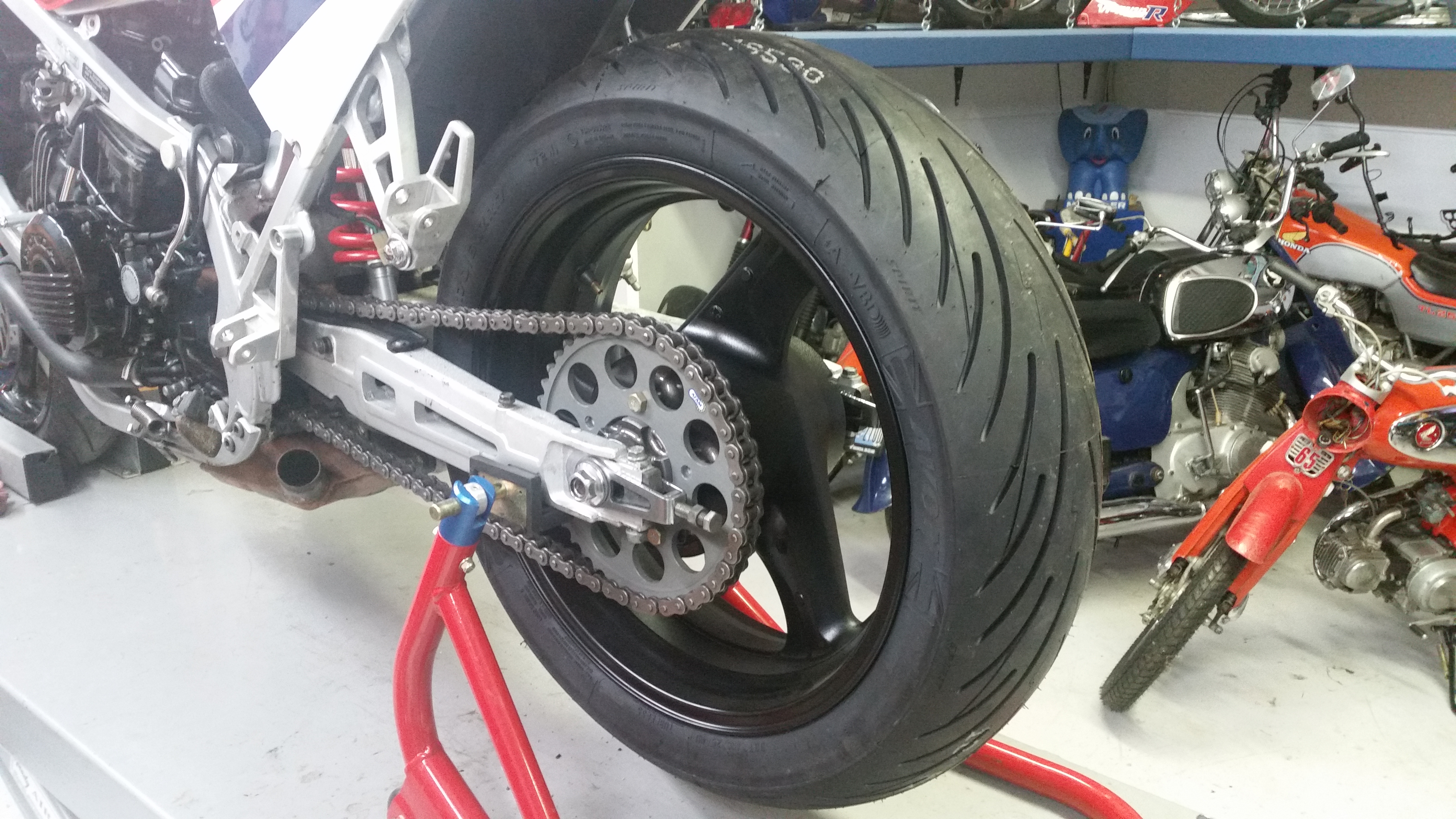

    Tire mounted. Temporarily installed wheel so I can turn it around and remove front wheel for paint.
    Tire is a 170/60-17 that has a real width of 177mm mounted. Working on brakes next and finish assembling the bike.

    Thank you very much. Should greatly improve the feeling of this old pig. I was hoping the rear tire would be closer to a true 170. My clearances shrank a bit, but should be just fine. Can't wait to roll it outside and get a better perspective. It looks pretty sick though.

  12. jeremyr62
    jeremyr62 New Member
    Ireland
    May 14, 2011
    609
    42
    Limerick, Ireland
    Won't that tyre width foul on the swing arm? I fitted a 150/70 17 rear on CBR600F3 (I ithnk, CBR600FR over here) 17 inch rims and I had to mess with the sprockets and chain length to get the tyre as far back as possible so it wouldn't rub on the swing arm.

    #74
    8,387
    4,357
    No. It's closer than I planned on with my measurements, but should be fine. Like I said before, a true 170 width would be no problem.
    I have a 160/60-17 (which is stock for F2 and F3 by the way) on a F2 4.5 inch rim on one of my RC26 and it's not even close. Was your tire a Dunlop? They run way wider than the nominal size.

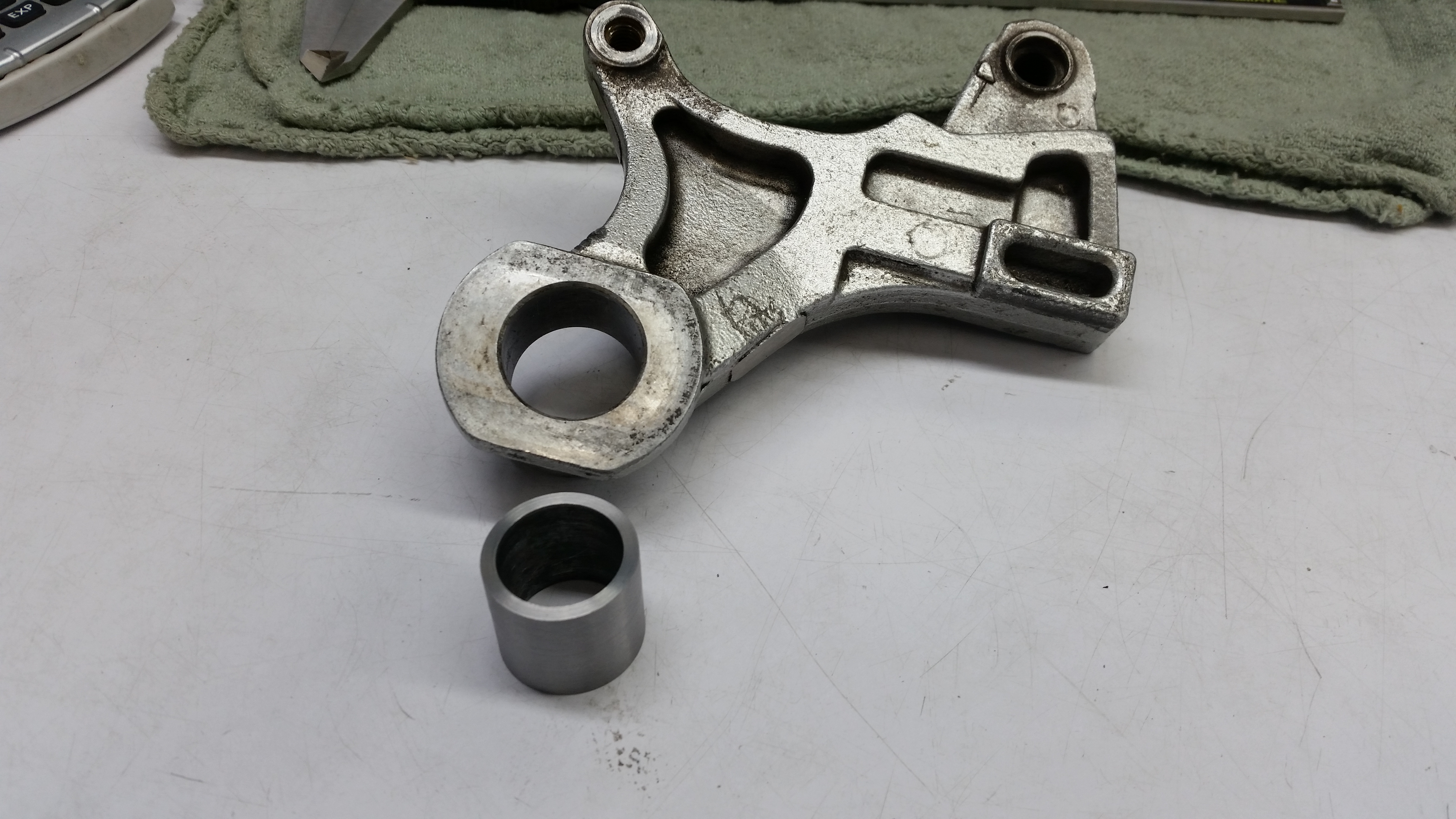

    Used my lunch to spin up the press-fit spacer that brings the 929 caliper bracket down to 20mm.
