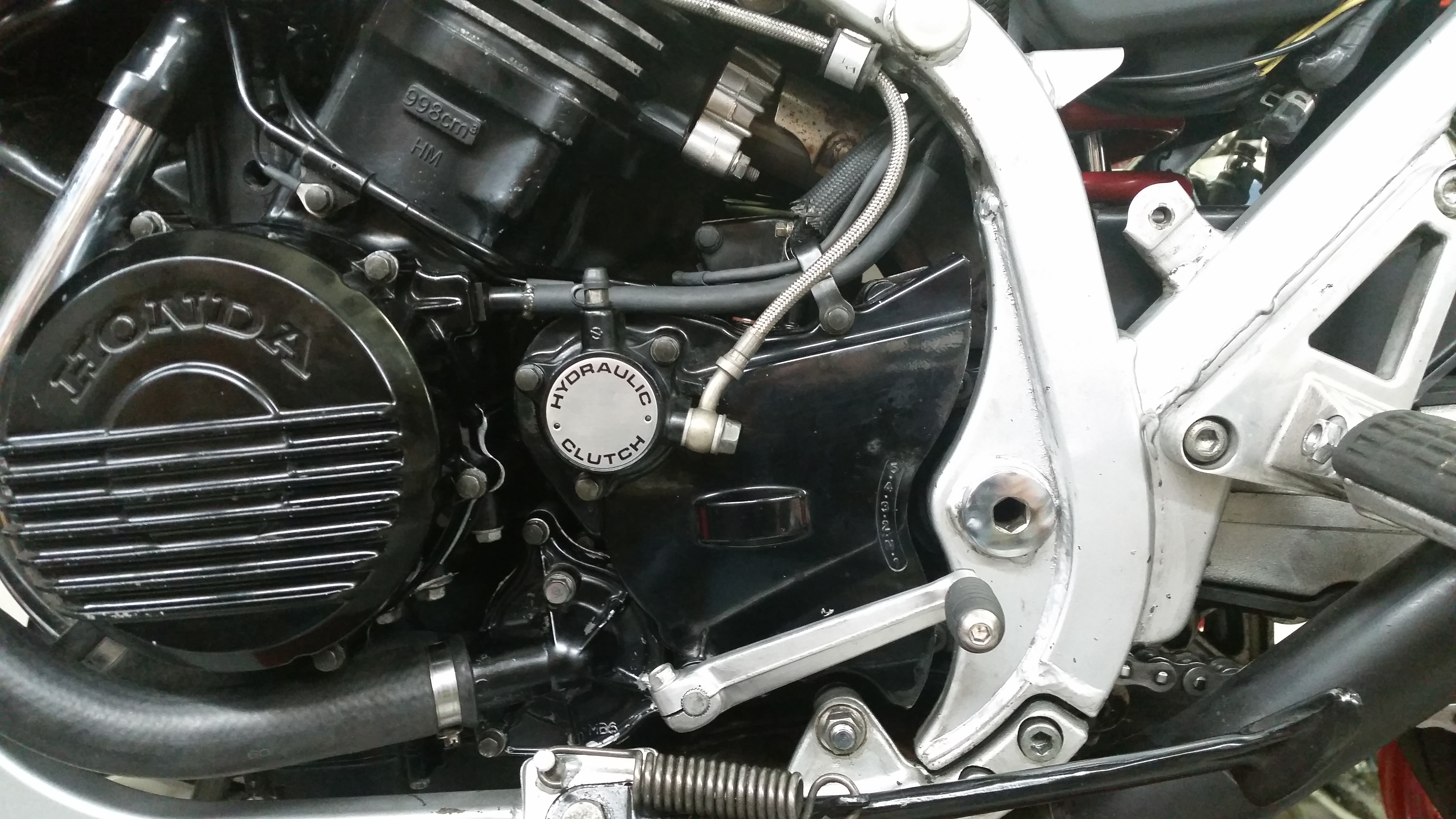

    Well that fucking SUCKED.
    Took me a whole Seahawks game to get that gasket off. Couple last parts arriving this week, hopefully test ride this weekend. Afternoon/Evening rides are gonna be rarer now that we've changed from Daylight Savings Time, brrrrrr.

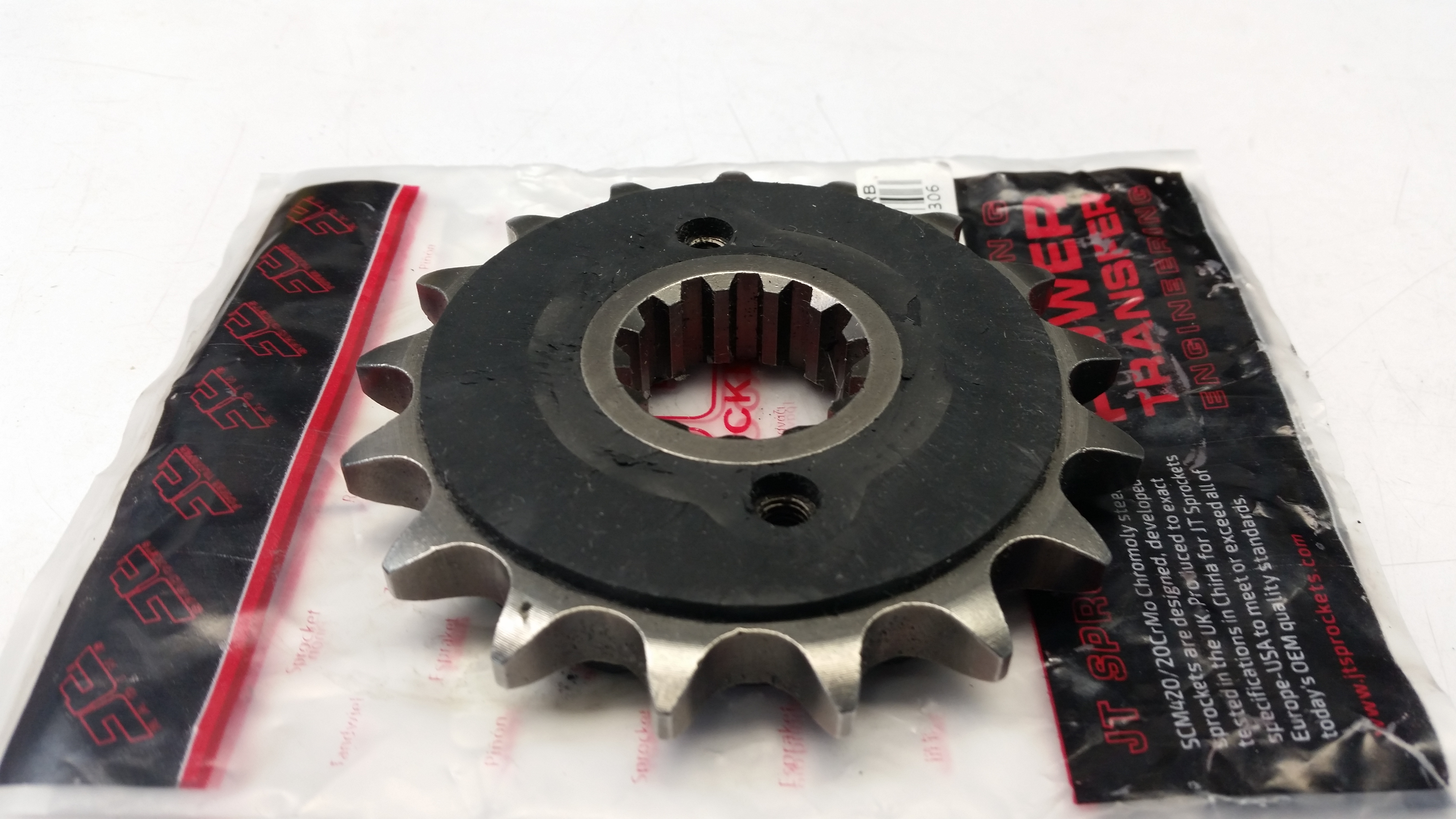

    Finally got the c/s sprocket. Went to install and the rubber contacted the bearing lip on the cover. So I had to shave off the raised sections of material on one side.
    Back to together now.
    Probably won't be able to test run/ride until this weekend. If it leaks now it's getting pushed in the corner to think about what it's done.

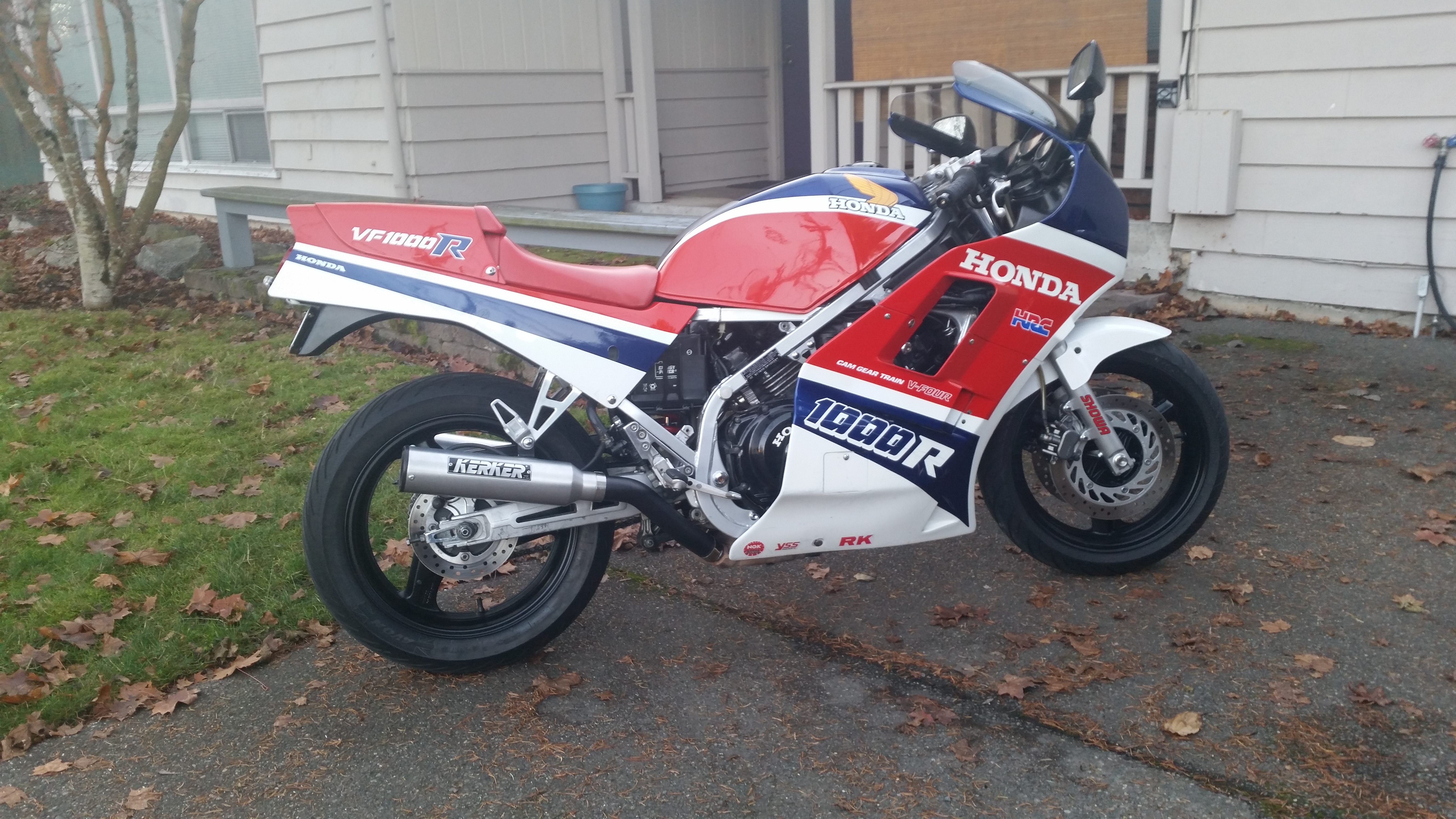

    Here's how she's looking now, back together.
    Eventually when I dive deeper for some maintenance I'll pull the whole exhaust and re-finish. Probably gonna need a seat cover soon, it's getting pretty stiff from age. Oh, and I want to modify a set of passenger peg mounts to be just muffler mounts. And I might have some custom connecting pipes made to use a set of Two Brothers Oval canisters I have, mounted a little higher with custom brackets. And...

    Jetting change. Slight stumble WFO, the rest is perfect. Not fun, but gotta be done. 125 to 130 Mains.

    Jetting change is awesome. What a difference. No stumbles, thing pulls like a freight train, way harder than before. Stopped by a friend's for a 6 foot beer. Oh, and I swapped rear fenders with one of the other 1000R. This one can be a little more racy, the other one deserves a nicely trimmed unit that looks stock-ish.
    Eliminated the front under fairing mounts, they were fouling the front fender in low speed turns with suspension compression. And added some running lights in the turn signal bracket reliefs.
