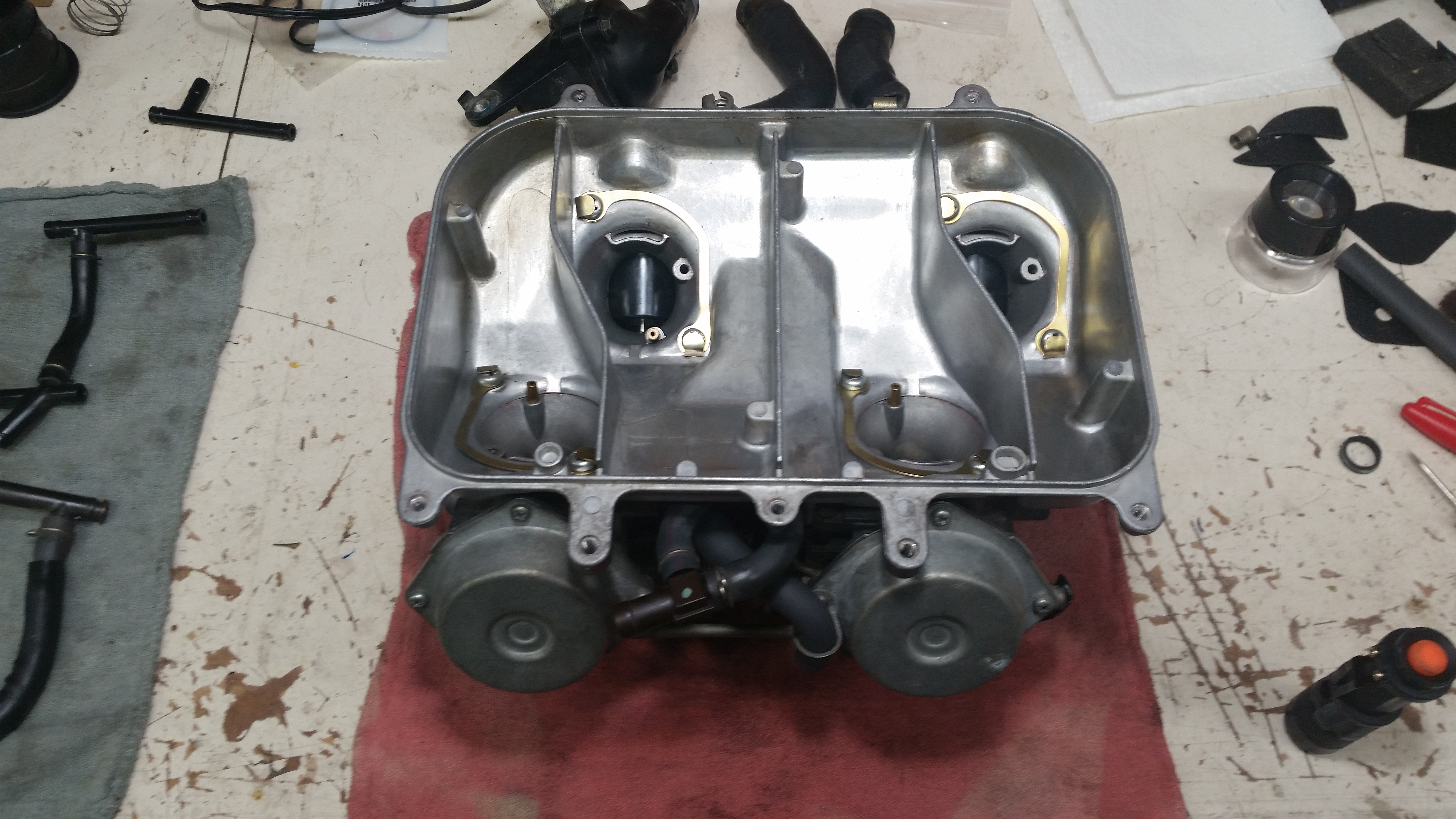

    Another conversion done.
    8,566
    4,534
    Carbs are completely rebuilt, documented and bench synched. All new o-rings.
    Next up is doing all the coolant pipe seals / o-rings before installing carbs. I have them all, just need to roll the 1000R off and this up.

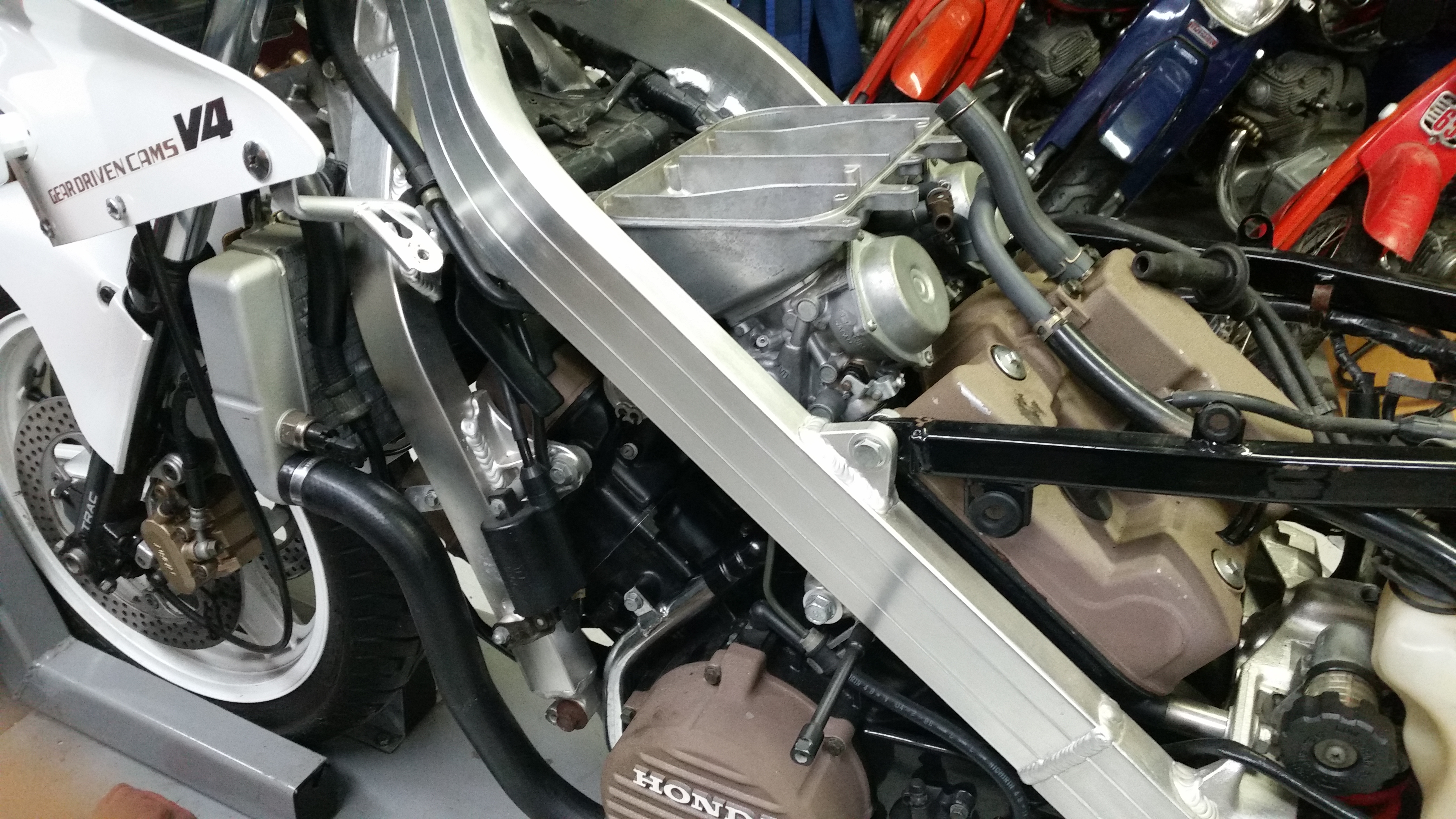

    8,566
    4,534
    Cooling system o-rings all replaced. Rebuilt carbs re-installed.
    Need to button up the intake system. Next the calipers will get dis-assembled and gone through as they are sticking a little bit. Should just need a clean up of the pistons and seals. Installing a 1987 shock (10mm longer) to compensate for the 1988 17" VFR rear wheel along with a CBR600F front 17" wheel. It might get a Fox Twin Clicker I have, haven't decided yet.

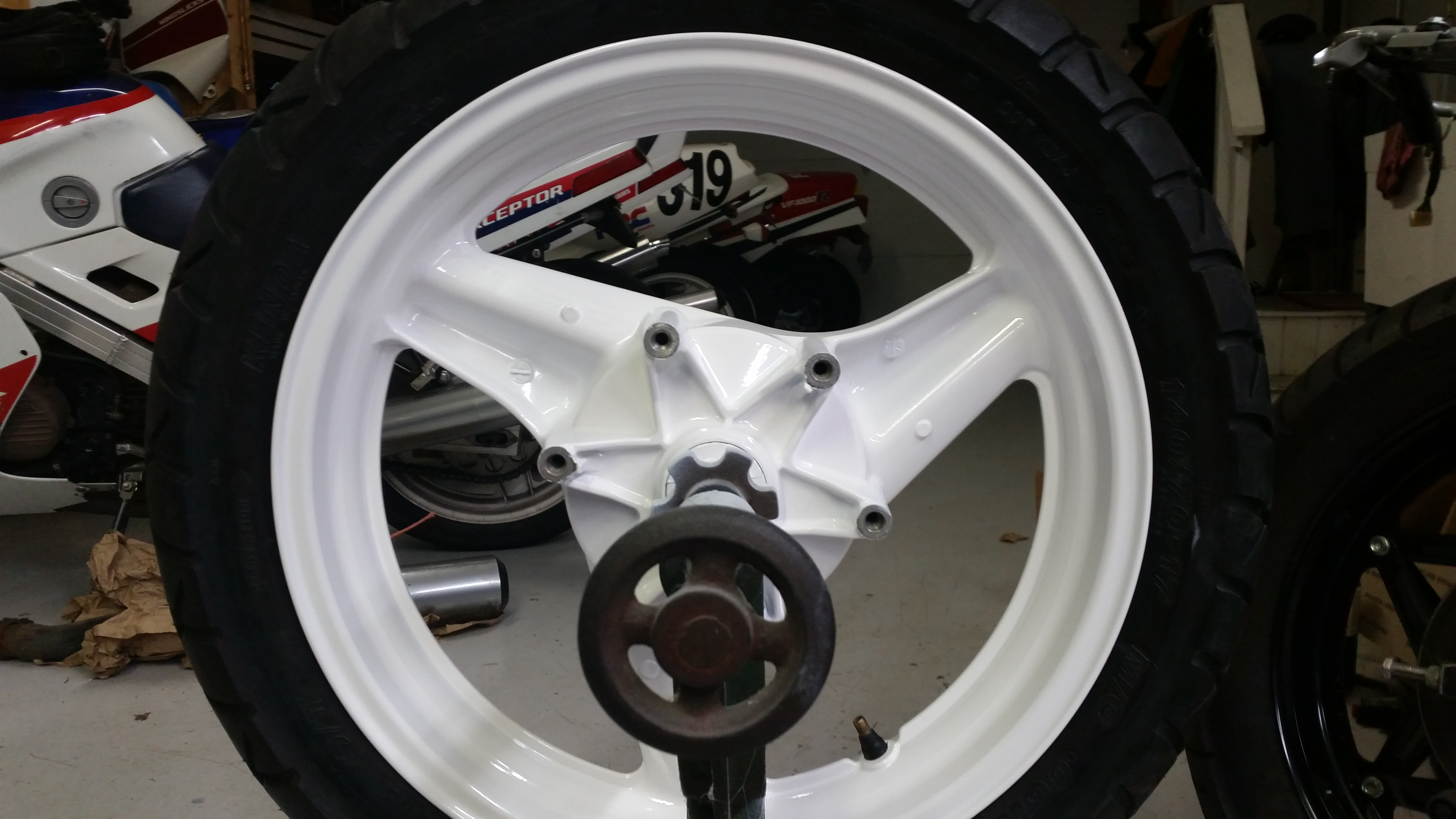

    8,566
    4,534
    17" CBR600 Hurricane Front wheel painted. New bearings on the way. Rear Euro VFR 17" is almost done being prepped. I sprayed the lips after doing the CBR wheel but have a little more blending to do. Should have it done later this week. Tonite would be a perfect night for some painting (mid 70s in Seattle!!!), but a better plan sounds like a trip down in the valley for a snack and refreshment this afternoon.

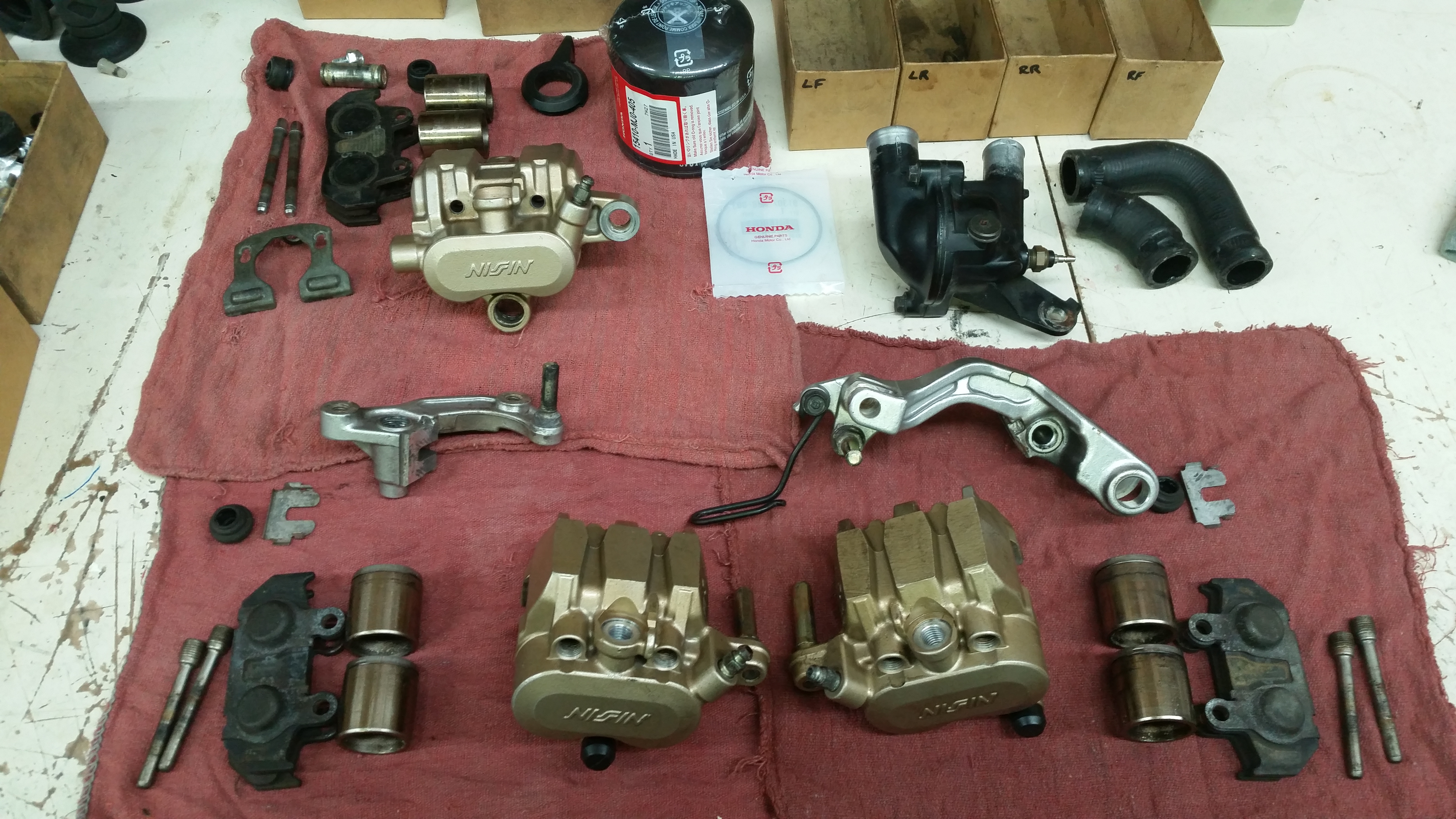

    8,566
    4,534
    Everything actually looks pretty good. Some gunk rings on the pistons. Will take the seals out for inspection / replacement and give everything a bath. Should be easy.

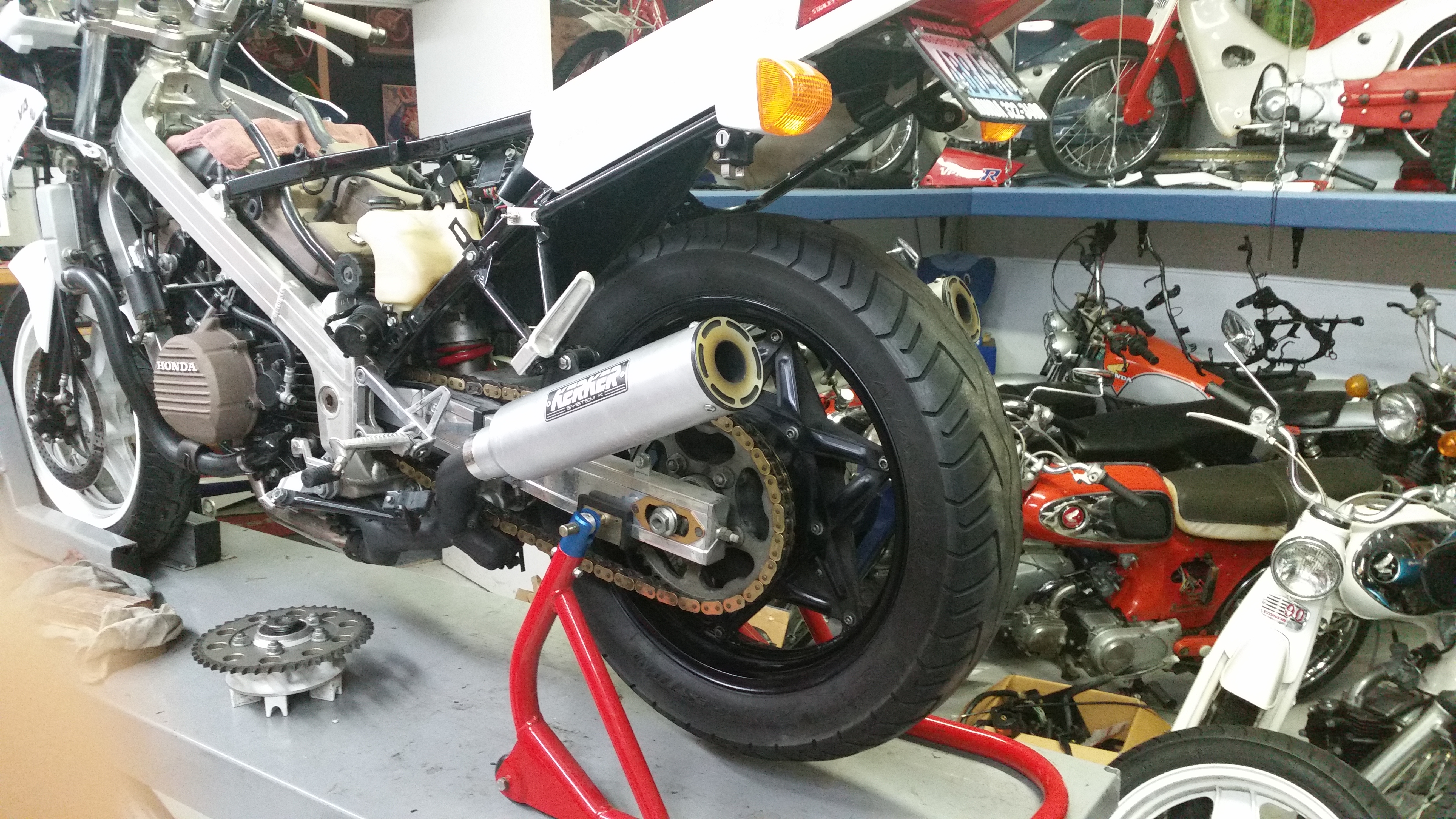

    8,566
    4,534
    Something you don't see everyday, Comstar on a 86 VFR. Using it so I could remove the rear wheel and pull the disc and cush and still have a roller. Now I can turn it around and work on the front wheel.
