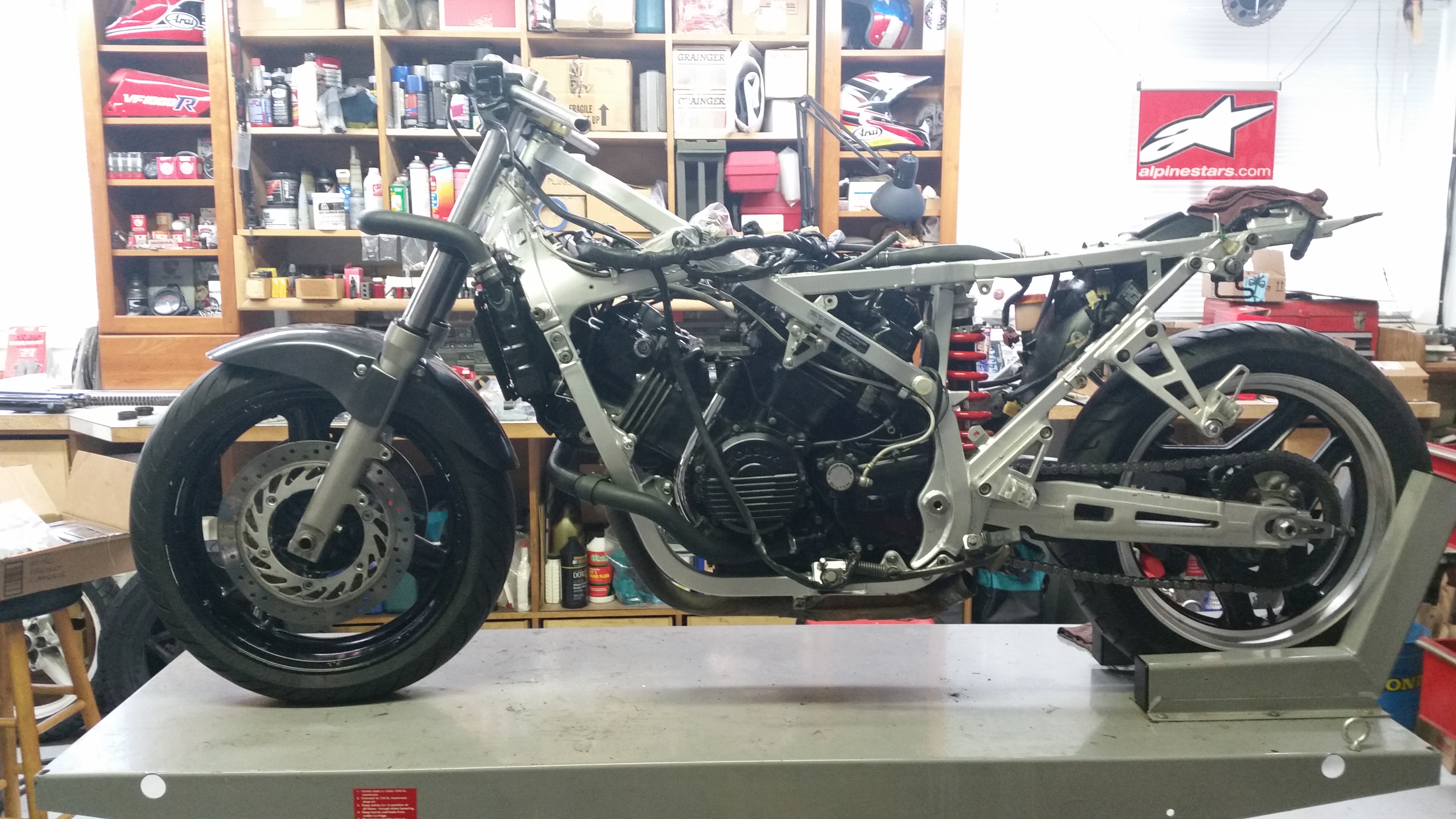

    The length of fork that is needed is one of the biggest problems. You may want to look at staying in the 1990 - 1997 range so you don't inherit a linked braking system (unless you want that). I currently have a set of 1991 VFR lowers with 1991 CBR1000F tubes on one of my VF1000R. The CBR tubes are slightly longer, but the setup is still shorter than the original. Shouldn't be a problem, as I run my 1000F with the tubes slid up in the triples already.
    https://vfrworld.com/threads/removing-front-suspension-air-crossover-tube.55115/#post-582852
    And the 1000R with the VFR/CBR fornt end. VTR1000F 5.5" rear wheel is next.
