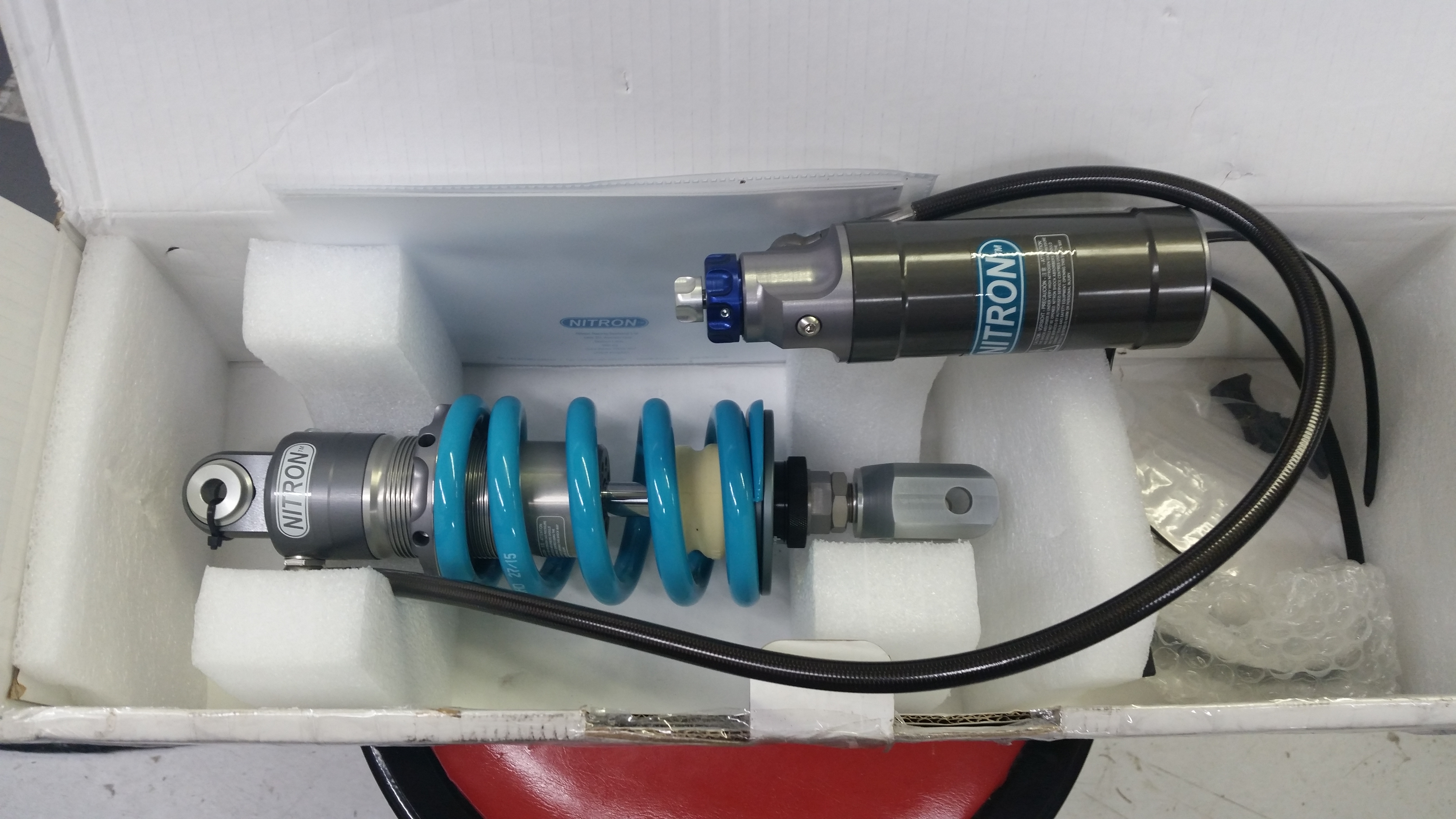

    Ride height adjustable shock of your choice. You can run a 1987 VFR shock for ride height too, I installed a nice low mile one on the white VFR. The RC26 has a CBR Fox TC that I modified to fit. Works great. I have another one for the VFR that is getting the CBR front end. The next build I already have a sweet Nitron remote res.
