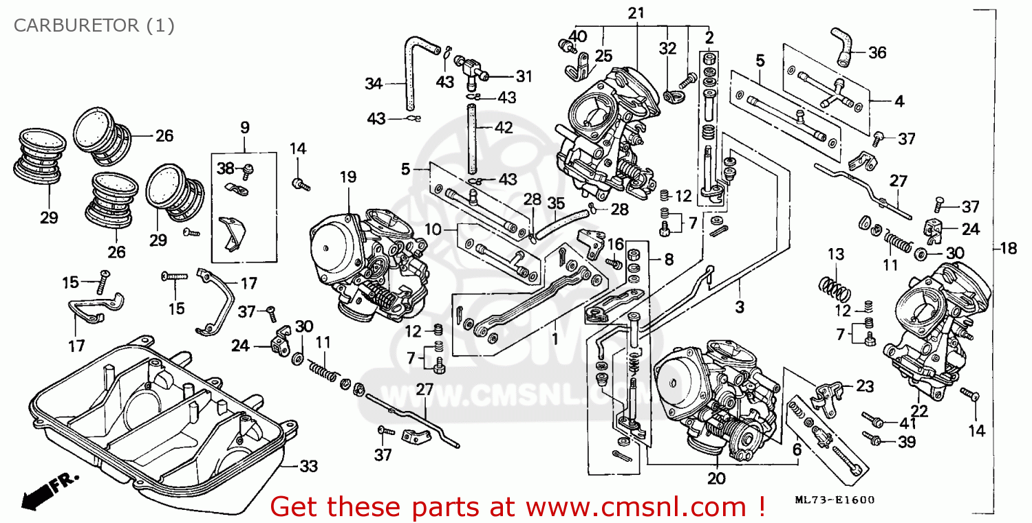

    if I get it right, you mean number 26 and 29 on this scheme, but I have a 1986 model and I don't have this funnels
