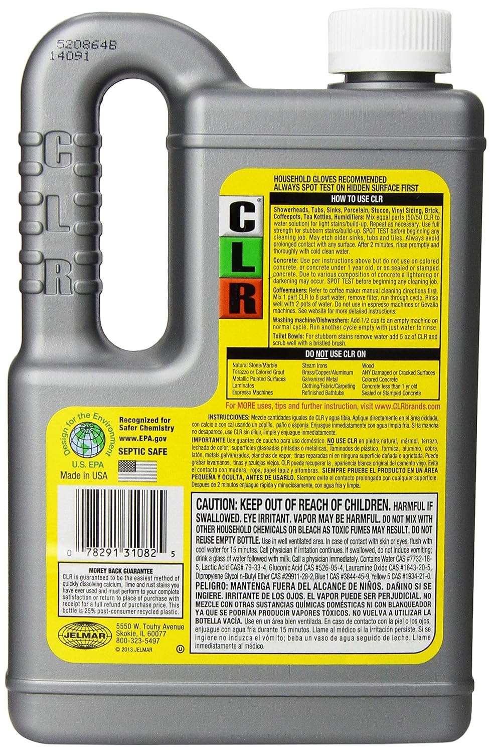

    Do you think CLR would damage the cooling system, doing a flush similar to what you described?
  19. gregrunt
    gregrunt New Member
    Oct 24, 2017
    According to the back label on the product, it recommends you not use it on aluminum. Isn't the stuff pretty thick too? I imagine if you had something that thick running through the pump, it'd put undue stress on it. Not to mention it could be difficult to completely flush out. So I'd stay away.
    34468 Randy likes this.
  20. 34468 Randy
    13,923
    1,704
    Though I have no expertise in this at all, I would certainly be eerie about running any kind of all purpose home cleaner through my bike. I would not with more safe and proven methods available to us here. Failing these, what it says in the owner's manual.
