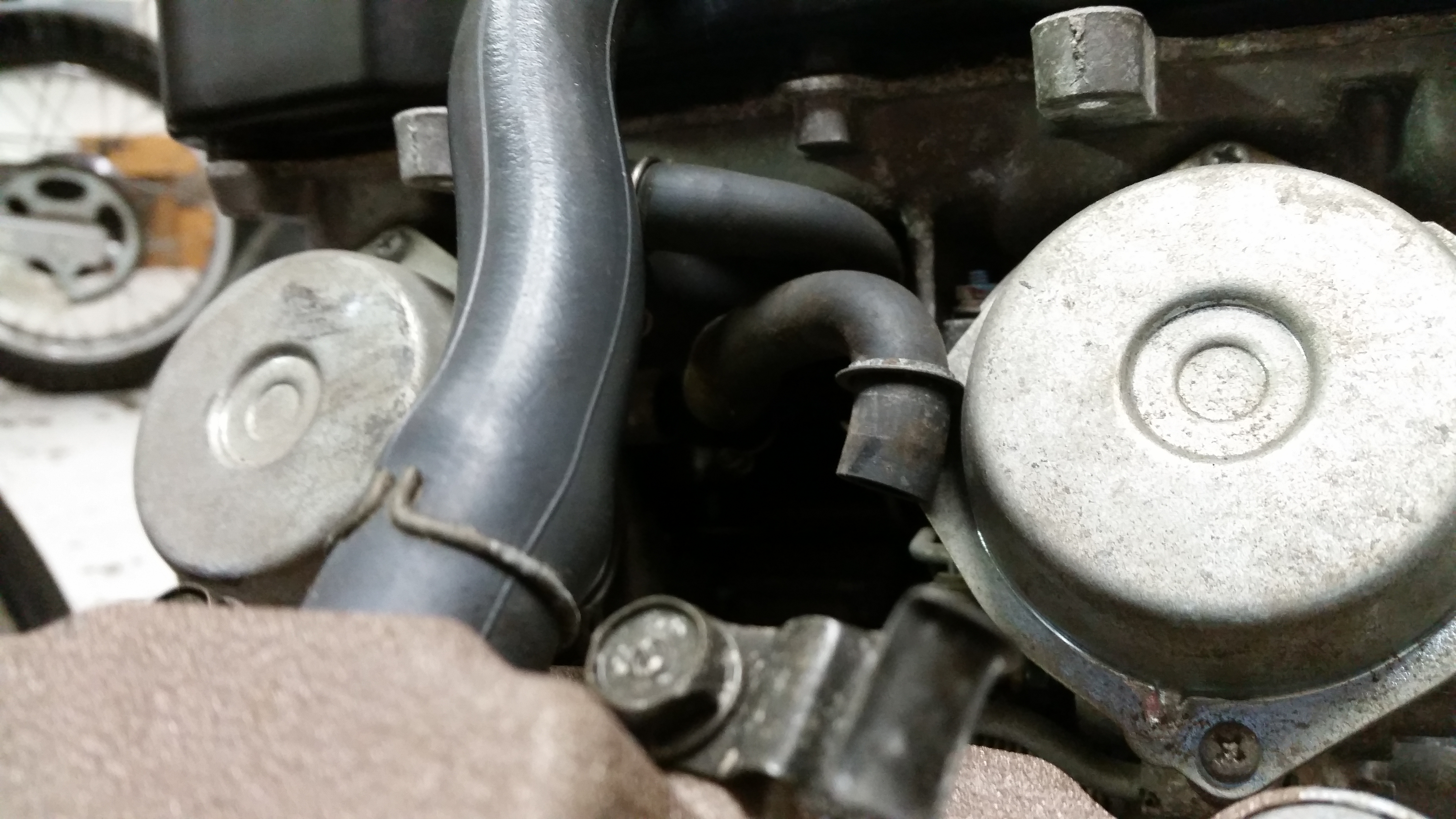

    Thank you Terry Smith! I'm really hopeful for it! Since the previous owner capped off the EVAP/PCV system. What should I do with that black tube coming out of the carb in the center between the fuel ports? Should i cap it?
    Captain 80s Insider
    1,183
    146
    Edmonds, WA
    Sounds like you are describing the primary vent tube. Do not cap it. It should just point down so no debris can enter. The right rear carb normally has a little holder attached with one of the diaphragm cover screws to direct it downward.
