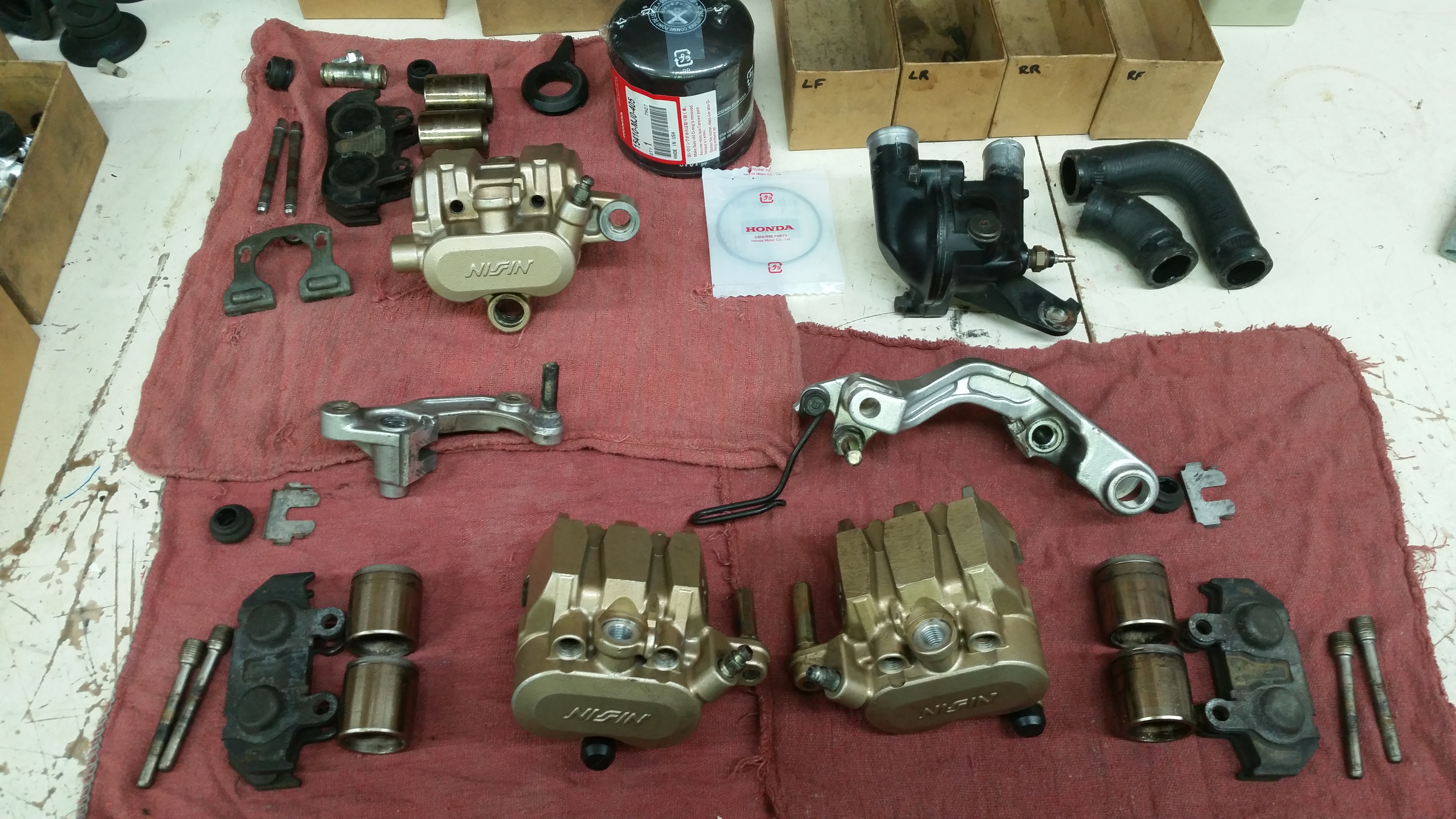

    I've got the pistons out of my calipers at the moment. They cleaned up pretty well, but there's still a few spots of build-up. I believe the pistons are stainless and hitting them with a brass wire wheel won't hurt them, but I didn't want to do that until I've exhausted softer methods. I've soaked in PB Blast and Kerosene and wiped hard with a towel, but this is as far as I can get.
    1. Can I take brass to the pistons without hurting them
    2. How close to spotless should they be before putting in the new seals?
  6. Captain 80s
    5,966
    2,463
    Looks like you need to differentiate between stubborn build up and pitting. The pistons are not stainless and have a coating on them that is easily damaged/removed. I use a little Mother's aluminum polish for the final "cleaning" and a quick wipe with some alcohol. Looks to me like you have some pitting on some of those pistons, especially that one 3rd from the left. Some slight pitting can be ok in the right area (not in the seal zone). But unfortunately that's where the corrosion usually is, especially when you have to press the pistons further in to accommodate new (thicker) pads. Get yourself a little magnifying glass if needed to see "pitting" vs "gunk".

    Ahhh I thought they were stainless.. poor assumption by me. I have some Mother's aluminum polish at home, and I'll give that a shot this weekend. Worst comes to worst I'll try to source new pistons. I've got new seals and boots ready to go for all three right now with some stainless steel lines on the way.
    The rear caliper was the roughest by far. Had a hell of a time pulling the sleeves out since they decided to eat the boots.
    I appreciate the suggestion and information.
  8. Captain 80s
    5,966
    2,463
    The rears are usually the terrible ones.
    You need to use a hi temp Silicone Grease when you install the new sleeves. Any other grease will end up binding the sliding movement of the caliper after a while, resulting in abnormal wear and bad brake performance.
