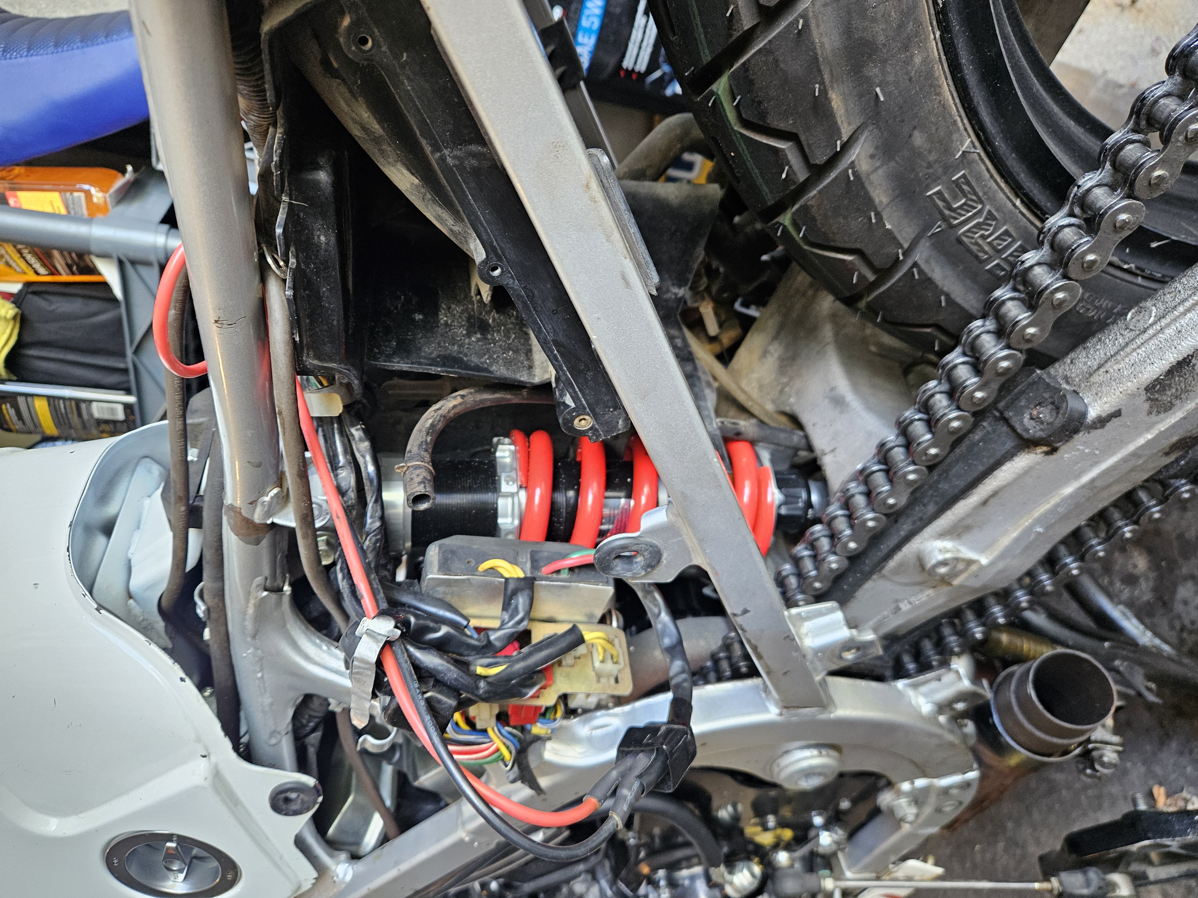

    Upgrade is here!
    Now if I can find the time for the install.. [​IMG]
    Aaaaaaand the pic doesn't show.
    It's the YSS rear shock
    Sent from my SM-S911U using Tapatalk

    Shock installed.
    I think it was harder to get the muffler off than to do the rest of the swap
    Electrical panel I took the bolt out and let it dangle.
    Angled, moved battery box to access top mounting nut.
    Remove LH muffler, chain guard and rearset just to get a grip on that muffler to shake it loose.
    I gotta say, nice to have the wheel off the ground when on the center stand.
    First ride was a big improvement. Thankfully, since this being the most expensive part Yet including the entire bike
    Made me realize now I need to do the front suspension

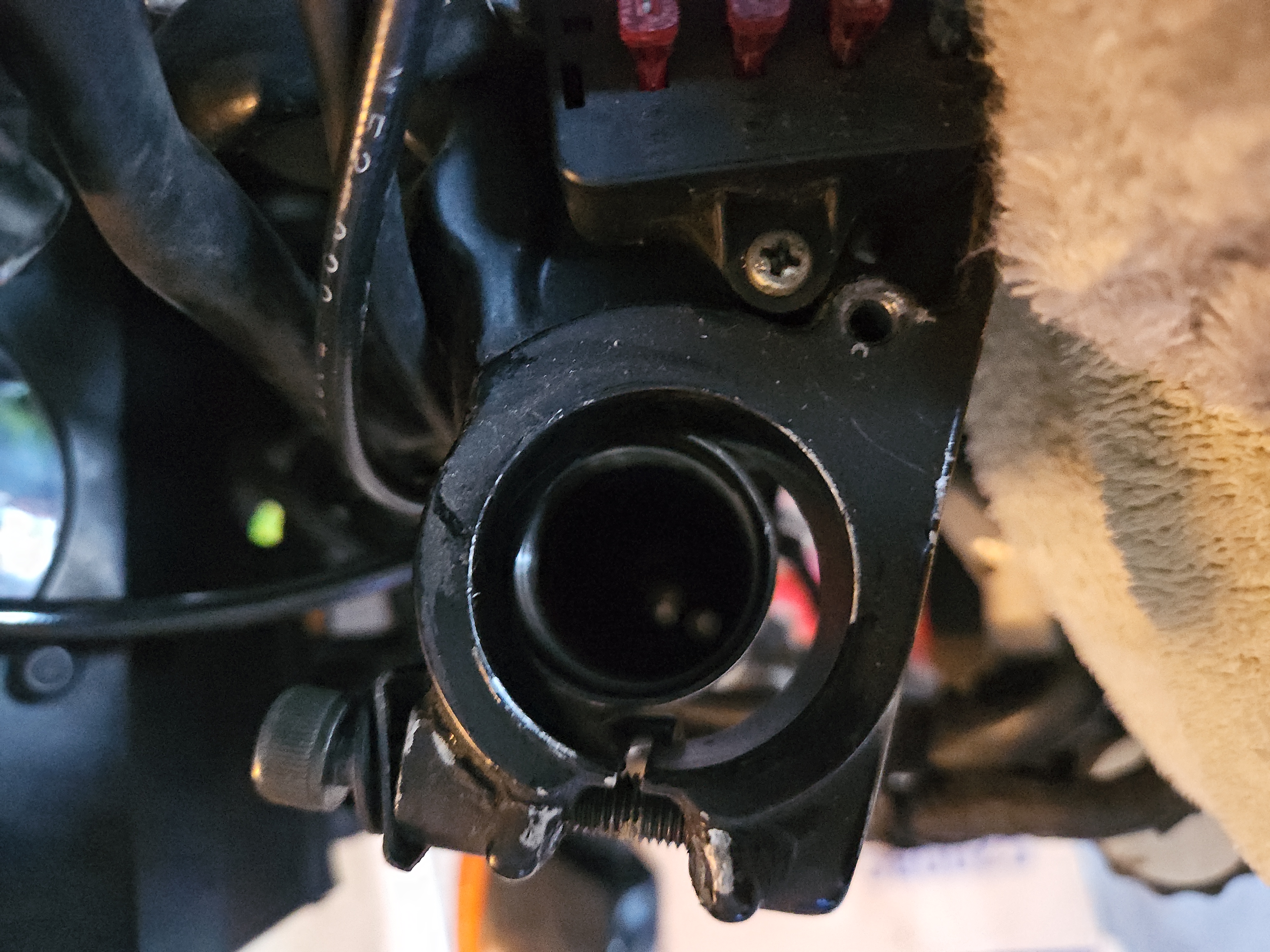

    Installed a better condition tail fairing panel and adjusted chain slack.
    New clutch lever and bushing.. man you could really tell the old ones were wore the Eff Out
    Seems the cush drive rubbers in the rear wheel are worn out/shrunken. I've got about 5mm of slop in the sprocket carrier when the rear wheel is held stationary. Might shim em, might order new rubbers

  9. Bazza
    Bazza Member
    May 26, 2012
    2,896
    1,260
    New Smyrna Beach, Florida
    The rear wheel I removed from one of my RC24's had these little rubber "slips" next to the regular rubber cushes. I'd never seen those before. They really kept everything tight!
    Sorry I didn't take a pic but they were thin slips of the same kind of rubber the cushes were and laid up right against each cush side.
  10. RogueRC24
    RogueRC24 Member
    May 25, 2021
    2,805
    1,597
    I would replace them. It will feel so much better and the cost is fairly min. I had to do the Hawk and it was night and day in about 1/2 worth of work and $45.
    jstehman likes this.
  11. jstehman
    jstehman New Member
    Sep 12, 2018
    450
    165
    43
    Yeah I was researching and saw people using old innertube material or plastic margarine tubs cut to fit to shim the rubbers.
    I'll go ahead and buy new ones. They are still available, and not too expensive. Hopefully bring a better feel to the transmission. There's definitely a rough feeling at the end of clutch engagement
    Bazza likes this.

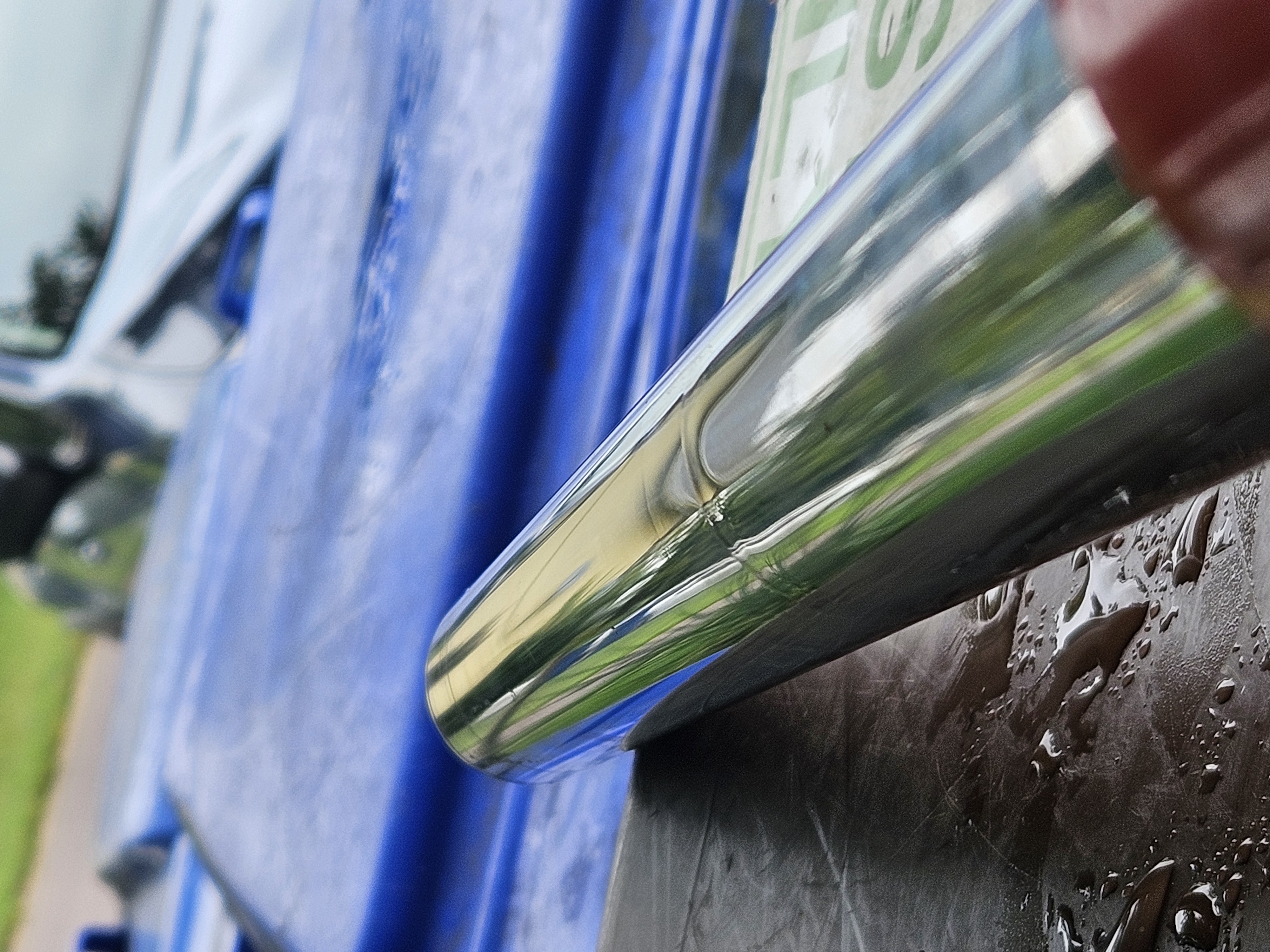

    It looks creased to me. pretty sure there would be some runout, but miracles can happen. ;) If you have another bike, go ride the late summer roads and worry about this in the winter.. hahahaha

    I have another inner slider I'm going to swap in.
    I took that creased one and laid it on the bench and it wobbles on a good portion of the diameter, if I roll it. That crease is definitely the fulcrum of the damage.
    Lemme get the new seals and buttoned up and I'll try resetting the triple clamps on install and hope the lower clamp isn't jacked up as well.

    Well, not much change in the fork position with the newer eBay slider .
    On to the left side. Too bad the left side replacement has a slight bend to it also. Might take that one and see if it can be repaired at the hydraulic shop.

    8,535
    4,502
    @jstehman
    Where are you? If you want to ship your forks to me, I'll straighten them. May be cheaper than paying a shop's labor rate.
