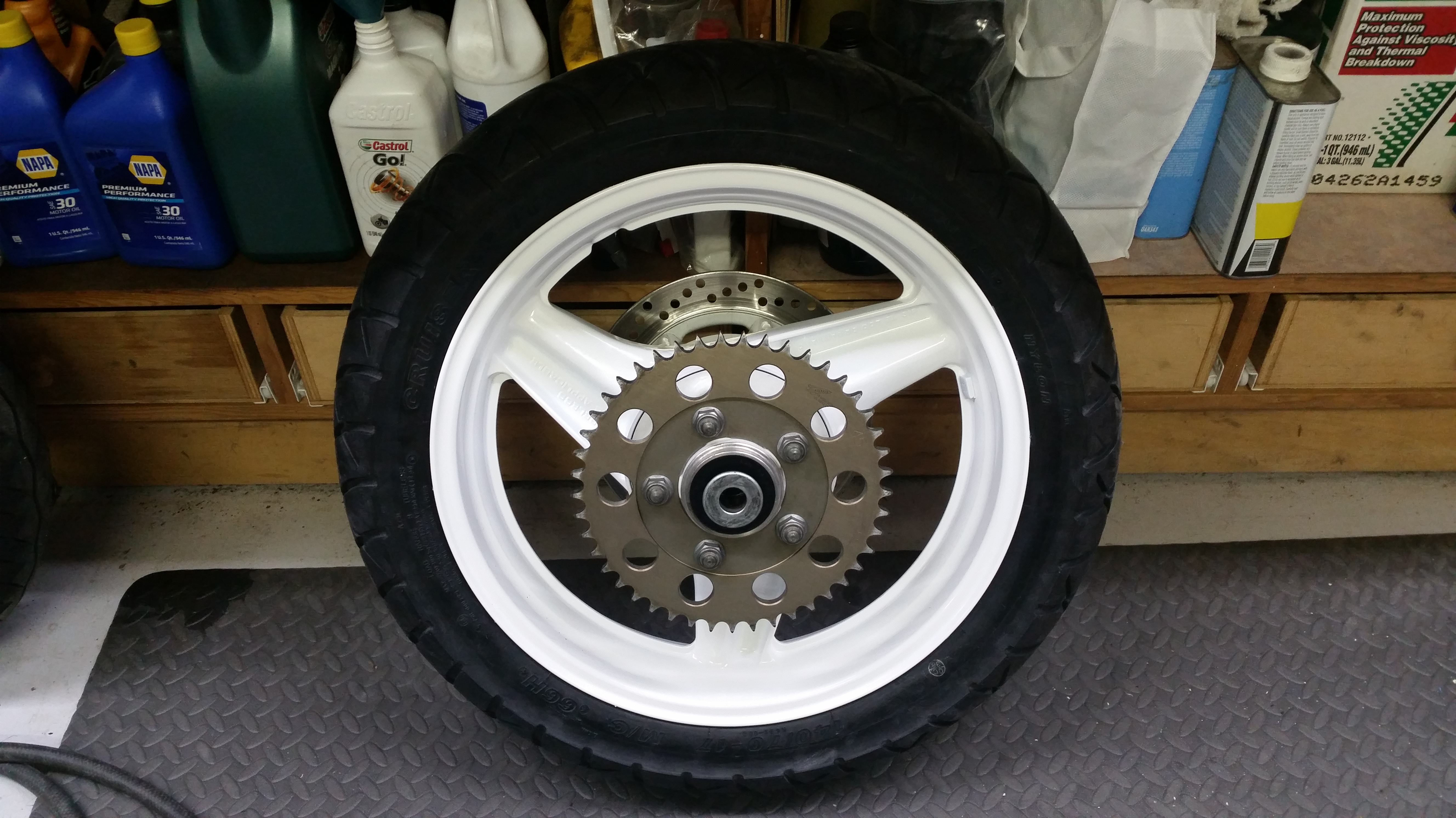

    [​IMG] Duplicolor makes a wheel paint that sprays nice and has proven to be durable. I've done 5 sets with it, about to do another.

    Did you media blast the rims first before painting, and did you clear coat after the paint coats?
  4. Captain 80s
    5,966
    2,464
    Thorough cleaning and sanding of the outer rim area. Final clean with some strong etching wheel cleaner made for unfinished rims. Etching primer anyplace that needed to be sanded down to bare alum. No clear coat, as it can have a tendency to yellow a bit on white. I use Duplicolor wheel clear coat on every other color.
    I did recently do a compatibility test with the expensive two part 2K Clear in a can and the duplicolor wheel paint (silver) and there was no reaction. That clear shouldn't yellow on white.
