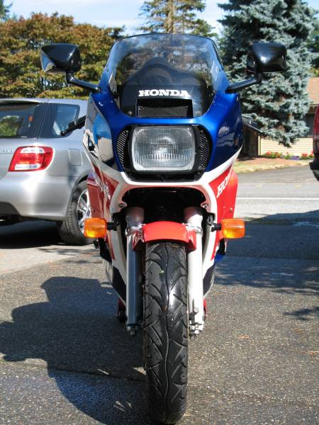

    8,331
    4,319
    Well they would have to update the North American parts system to support just for one year. I'm sure that had a lot to do with it. And the U.S. Department of Transportation was very weird in the those years, that's why the VF1000R came with a single headlight in 1985 to the U.S.

    I always disliked that one year only single headlight. Everyone else got the cool one!
    8,331
    4,319
    Me too. Well not dislike, just not like as much. Blacking out the surround helped for me.
    But, yeah... the pies on "Two Face" are nice. I experimented with a divider treatment for the headlights.

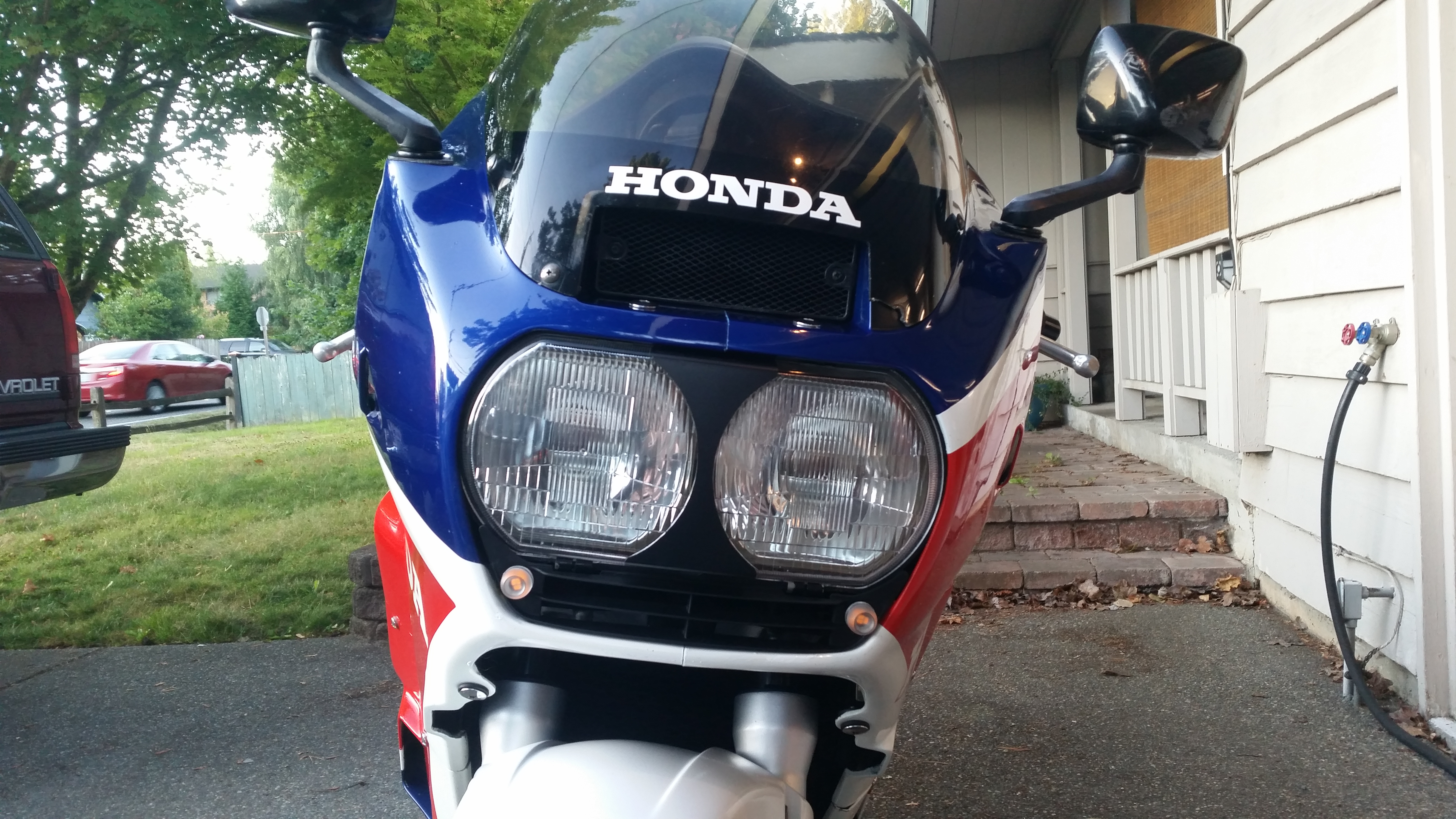

    1,581
    714
    I went that rout initially on my "Euro" VF1000R too, hoping to have it look more "euro - two eyed", but reverted to the stock look with the white on the surround, each to their own. Id prefer to have an actual 2 headlight bucket in there though. This may will likely get sold this spring.
    8,331
    4,319
    I think on that paint scheme, where its red and the upper white stripe is higher, the white looks better too. With the 86 scheme, it looked out of place.
