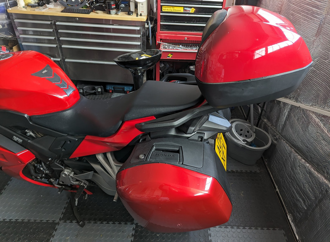

    To close the loop- yes it does fit.
    I managed to source a new one from Blackpool Honda...apparently the last New-Old Stock in the UK. Bloody pricey though...£283 without the top plate adapter. Heavy too, but very well made.
    Now got my 8th gen decked out with Crossrunner 800X panniers and top-box. The colour isn't a direct match, but meh, close enough and anyway I can't see the colour from the rider's seat!

    Picture with crossrunner kit on pls
