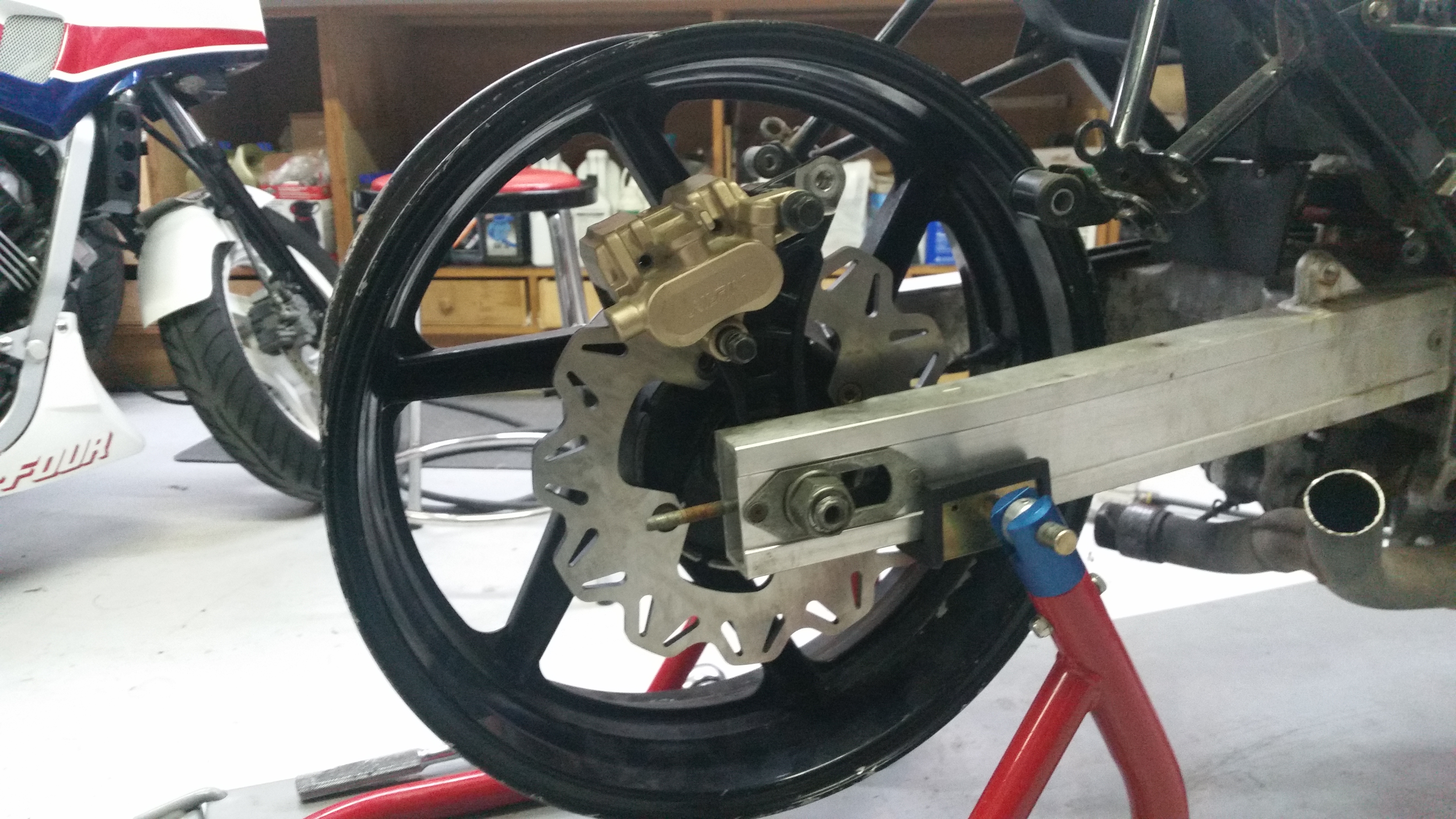

    Having front and rear wheels the same size is unsatisfactory for me. F2 (4.5") or F3 (5.0") are the easiest, somewhat match that wheel and get you a perfect fitting 160 modern radial to go with your new front radial set-up. 14mm left side spacer with the CBR sprocket carrier gets you factory wheel center. Technically by measurements the sprocket would then be about 2mm too far outboard, but on some VFRs it lines up anyway (I've found every bike can be a little different). On one of mine I just flipped the CBR sprocket around as it is "dished" about that amount and it was perfect. Eventually I will mount a hub on the lathe and take a couple mm off the sprocket mount face for brainless future proof sprocket changes.
    The hardest part is deciding how to handle the rear brake. I have done 4 different approaches and am happy to talk about them if needed.

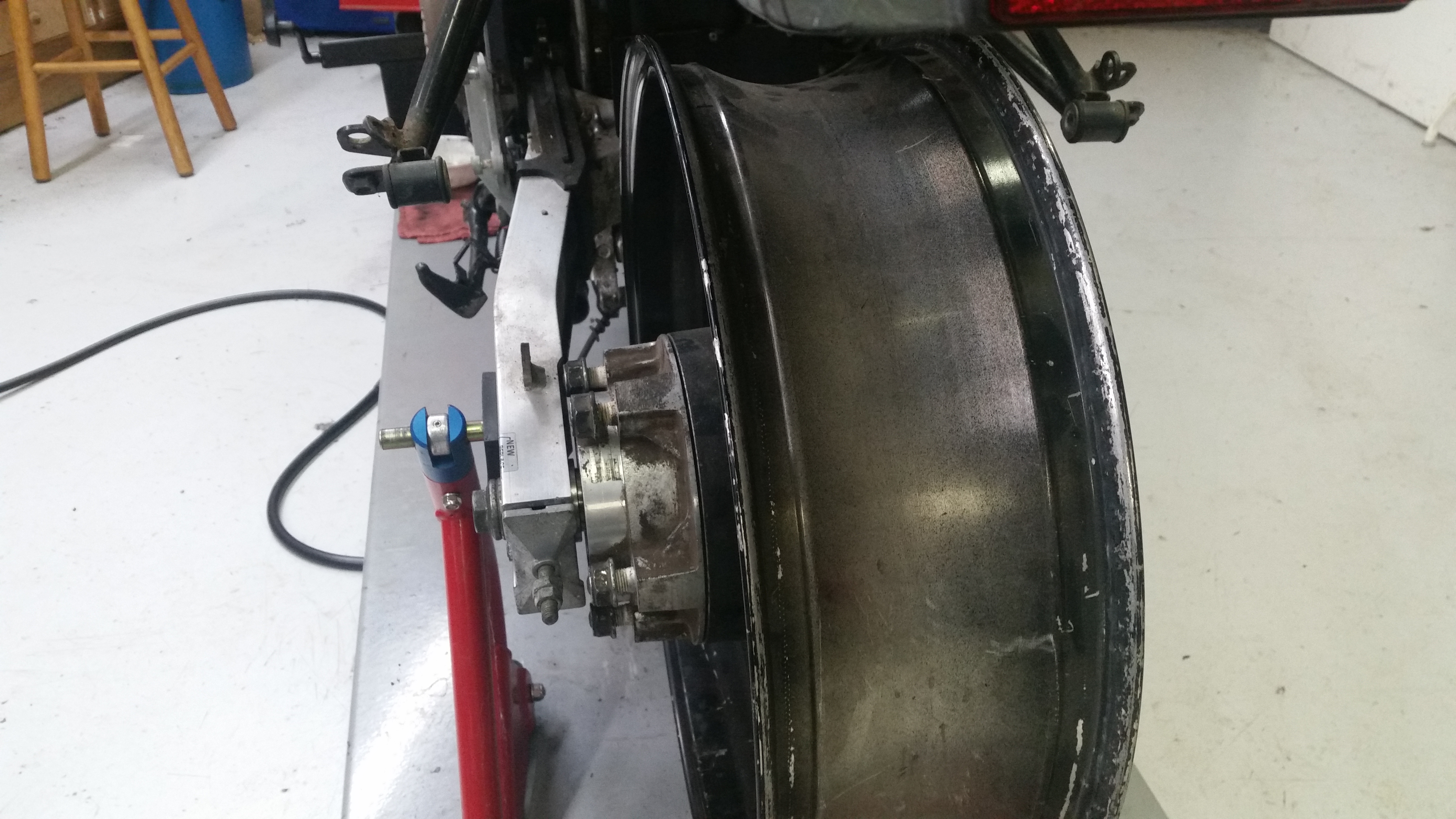

    I will detail some brake options in another post when I have more time. But the one pictured above is the closest you'll get to "bolt on", with only one custom spacer required (If I remember correctly... I have notes). It uses a Triumph rotor that has the same outside diameter as stock and the same bolt pattern as F2/3, allowing the use of the existing caliper and bracket.
